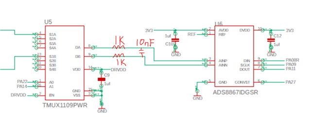

  • Hi Keith,
    Good suggestions, how do I attach a schematic for the following questions:
    1. How does the 3V3 and DVRDD look with regards to leakage? In particular the TMUX part to the A/D input.
    2. On the DRV425, what values for the filter and shunt resistor, or how to calculate them?
    3. Any other inputs or recommendations appreciated.
    Note, only one DRV is illustrated on the schematic, I'll add a second and possible a third later.

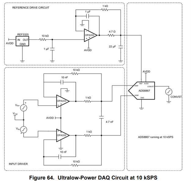

  • Hi Alan,
    The image still did not load.  There is an easier way (I just discovered); drag the *.png image file and drop it into the text window.
    It will insert the image in low resolution, but you can click on the image and adjust the resolution to something higher such as 800x600.
    Below is an example out of the ADS8867 datasheet.
    Keith
  • Hello Alan,
    I suggest keeping the TMUX powered directly from the 3V3 supply.  The supply current is less than 1uA.
    You will want to move the filter from the input of the mux to the output of the mux and keep it in a differential configuration.  1k resistors and a differential 10nF cap will still allow for sample rates up to 4ksps.
