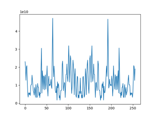

  • Here is the plot of the absolute value of the Range after a single 1D fft across the samples within the chirp.
    Charlie

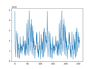

  • This is the same process, but with a hamming window applied
    there shouldn't be targets at these positions

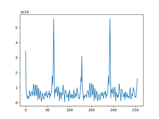

  • Hi Zigang,
    Thank you so much for the help. That seems to have made it work.
    this graph is more what I expected.
    Charlie
