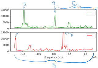

    I included a new snapshot below where the green trace is without the fftshift and the red one is with fftshift (to correctly display the FFT output) What I understand from your message is to discard the negative frequency data in the green curve and to only use the data in the positive frequency range (where the maximum frequency is half of the sampling frequency as shown - my sampling frequency is 2.5 MHz by the way) When I calculate the maximum range for the positive half of the green trace, it is half of the maximum range I should be getting. Therefore, this tells me there is something wrong and the entire frequency range (i.e. positive and negative ones) need to be taken into account.
    This brings me to the red trace shown below, where DC component indicated with 'A' has been shifted to the minimum frequency (i.e. -1.25 MHz) as indicated (through deploying fftshift function on the green trace) I also indicated point 'B' to show where the negative frequency components appear after the fftshift. Since I use the entire frequency range in the red plot, this is equal to my sampling rate 2.5 MHz as indicated, and will give me the maximum range as expected.
    Because the DC component has shifted to the minimum negative frequency in the red trace, this frequency needs to be mapped to 0 Hz, which means the maximum positive frequency in the red trace maps to 2.5 MHz.
     My guess is we are both saying the same thing but in different ways. Perhaps I should just ask the following to clarify:
    When I feed N complex ADC values to FFT and obtain N complex output values, I do not discard half of the complex output values (as in the "real only" input to FFT case) as all of these values map to a particular range bin. All of the complex FFT output values I obtain will cover the full sampling frequency range. Is this correct?

  • HI,
    Yes, all ADC sample should be used for range FFT and FFTSHIFT should not be used after FFT function.  IF the red curve is more close to your expected spectrum.  Then there must be some error in your data parsing.

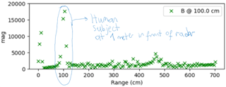

    I am working on formally collected and labelled data in my research and following is a snapshot of an instance where there is a human subject standing right in front of the radar (i.e. azimuth boresight angle is zero degrees) at about 1 meters. (This is the ground truth information from the actual data collection) In this particular data collection in a controlled environment, there was no other human subjects or other objects at 1 meter range either.
    I plotted the following with the FFTSHIFT I have been talking about using the complete output of the FFT. Notice the x-axis values I computed using the shifted frequency bins. I circled the range bins with high magnitude in blue. As you can see, the range FFT data with the FFTSHIFT I used perfectly agrees with what I expect. Had I not used the FFTSHIFT after obtaining the FFT output (i.e. kept the negative frequency locations as they were without stitching them to the back of the positive frequency range), the human subject would appear at around 4.5 meters, which is not correct. (Assuming the minimum negative frequency corresponds to 0 m distance from the radar)
    I actually looked at other instances of the same data collection session where the subject moves between different reference points (from 1 meter to over 4 meter ranges), and all of the range plots actually agree with the ground truth data I have. So given the data evidence I have, my current interpretation of the FFT output and the frequency bin to range bin conversions seem to be accurate.
    I am also thinking about your insight on NOT having to use the FFTSHIFT and leaving all the negative and positive frequency bins where they are. If that is the case, between 0 to 3.5 meter range the results will be the same. However, objects between 3.5 meters and 7 meters, will appear in the negative range. Therefore, an object at 4 meters will be plotted at -3 meters, and an offset adjustment will be needed (i.e. actual range = maximum range + negative range value) to get the correct range reading.

  • Hi, Cagri:
    It could be the definition of built-in FFT function are different.  But I agreed that your range FFT output picture showing in the last return looks correct to me.
