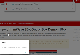

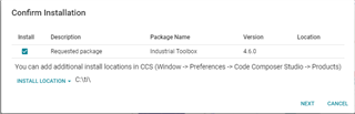

When trying to download Industrial Toolbox version 4.6.0 or some older version which contains out of box demo for IWR1843, an error occurs shown as below.
Could you pls help check the reason? Thanks.
Could you please inform me of the browser you are using? Could you try using theo other in Firefox or Chrome?
I would also try clearing your cache. If issues continue you may have to try a different machine.

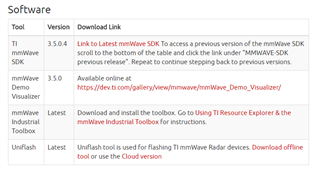

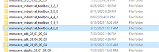

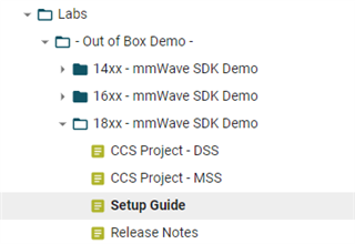

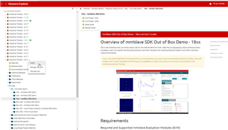

The instructions to import a CCS project are described in the Out of box demo. Projects are imported after installing the toolbox and the mmWave SDK. Could you try the following from within CCS? You can find instructions in the 'Setup Guide' from the screenshot you have posted.
This is not how a project import is done. Please follow the directions described in the link below. These are instructions that assume you have opened Code Composer Studio, not from the web. Please read the directions carefully.
