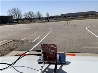

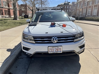

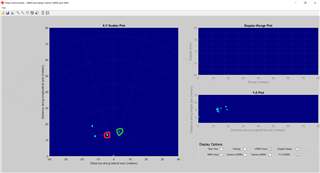

Currently, I am testing the mrr beam steering lab of automotive toolbox 3.2.0. However, I found the compiled code gives me wrong detection angle in the azimuth plane. Below is my setup.
(1) I am using the default mrr beam steering example code. From here (AWR1843BOOST: MRR Beam Steering Lab for MRR and USRR), I learned the beam steering only applies to the USRR. In my application, I also only use USRR. So I commented "#define SUBFRAME_CONF_MRR_USRR" and uncommented "#define SUBFRAME_CONF_USRR"  in both mrr_18xx_dss/common/mrr_config_consts.h and mrr_18xx_mss/common/mrr_config_consts.h. I left everything else as default, namely, I included "#include "mrr_config_chirp_design_USRR30.h" and used the default beam steering settings from -60 to 60 degree with 20 degree in step increase.

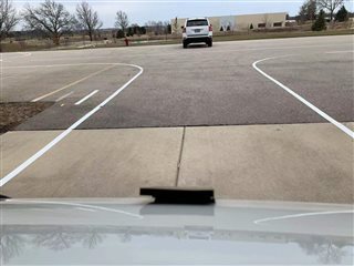

(2) I put a car right in front of the radar, like the picture below for testing.

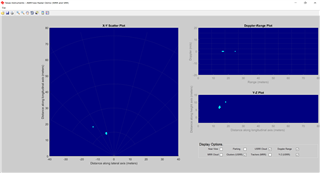

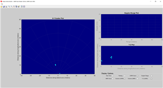

(3) However, the testing shows me the wrong angles in both the azimuth and elevation plane as the picture below.
From the picture above, we can see the car was detected. However, the angle in azimuth plane and height (Z) were wrong. It showed the car was detected at around 14-16 meters away at more than -15 degree in the azimuth plane and the height was detected more than 5 meters. In fact, the car was right in front of the radar and the car itself is less than 2 meters.
(4) To verify my guess, I stand in front of the radar and move back slowly. During this time, the radar can detect me. However, it detected me in the wrong angle in the azimuth plane (the same direction as the car).
I am guessing, something was not working properly from the given mrr beam steering lab code. I am using the lab code from automotive toolbox 3.2.0. Any suggestions on how this wrong but consistent detections (angle and height) happens?
Thank you so much!

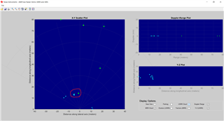

    I did one more test and had one founding for you. I was using #define SUBFRAME_CONF_MRR_USRR and #include "mrr_config_chirp_design_USRR30.h".
    From the picture below, we can see the MRR cloud detected the vehicle with correct angle in the azimuth plane. However, the USRR cloud detected the front vehicle with wrong angle in the azimuth plane and wrong height (Z axis). The red circle I marked is the front vehicle detected by the MRR and USRR. Maybe something was wrong with the USRR code?

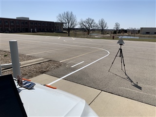

  • Hello Aayush,

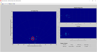

    I just confirmed that the prebuilt image of automotive toolbox 3.0.0 for USRR also gave me wrong angle estimation in the azimuth plane. I used the image from this path "C:\ti\mmwave_automotive_toolbox_3_0_0\labs\lab0007_medium_range_radar\prebuilt_binaries\xwr18xx_mrr_demo.bin"

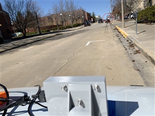

    Here is my setup, I put a reflector right in front of the radar around 10 meters. However, the radar still gave me the wrong angle estimation. Hopefully, you can reproduce this issue and could you give me some advices on fixing it? I am only using the USRR for my project.
    Thank you very much for your generous help!
    Hang

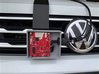

    Thank you for confirming this and using a strong reflector as your target. I wanted to make sure that this issue wasn't due to regression when the MRR lab was updated in toolbox 3.2.
    As you also encounter this issue with the MRR lab in toolbox 3.0, it isn't likely that this is due to a bug in the lab, as the MRR lab was well tested. I have a few ideas in mind and would really appreciate if you could try these out:
    1. Could you try the out of box demo in the SDK? This would be to eliminate basic issues in your physical setup as the root cause. If there is an issue with the MRR lab, you shouldn't see this discrepancy in the OOB demo. If you see the same discrepancy in the OOB demo, it is likely that the issue is with your physical setup, like the level of the mounting surface being off, object not being aligned to the EVM's boresight, etc.
    2. Could you capture a few seconds of data sent from the device with a serial monitor like teraterm/putty/etc and attach it here? All you would need to do is to listen over the auxiliary data COM port at a baud rate of 921600. The MRR lab starts to send data as soon as it starts running, without waiting for any external commands. It would be helpful to see the error in data.
    3. This might be a long shot, but is the enclosure in your setup metallic? Perhaps the lip of the enclosure being right next to the transmitters/receivers is causing some sort of reflection/coupling/interference? It would be worth trying a more open mounting mechanism, like the tripod mechanism in the video you linked to above, or using the L brackets provided with the EVM.
