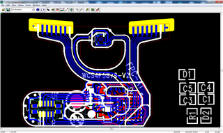

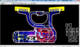

Could customer change the layout from 1 to 2?
1:
2:
The GND trace does not need to go around the chip, right? Customer want to change the GND from Upper right corner to lower left corner (from1 to2)

Hi Amelie,
It is a little hard to read, I am assuming that the white trace is the GND in the option 1 and this moves to blue layer in option 2. This type of change seems fine as there is no specific GND requirement for this device about GND going around the sensor. GND just needs to be properly connected.
