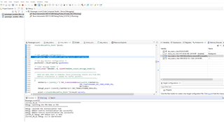

  • Hi  first of all thanks for the information   ,
     NOTE :   i understand  the HW and mmwave_sdk_03_05_00_04   structure  in CCS10.2
     our demo   base on Area Scanner for Zone Occupancy Detection example
    1. we have made changes  in alg part
    2. we have python script which we sending to cli i put breakpoint( hw )  in mss_main.c  in the begging  function MmwDemo_transmitProcessedOutput    which i expectged  to stop when i send all configuration via  CLI  with python script
    but   we never stop  at this function
    Q1:  there is significant  which run first dss or mss  ?
    Console output
    [Cortex_R4_0] **********************************************
    Debug: Launching the MMW Demo on MSS
    Debug: Launched the Initialization Task
    Debug: mmWave Control Initialization was successful
    Debug: mmWave Control Synchronization was successful
    [C674X_0] Debug: DPM Module Sync is done
    [Cortex_R4_0] Debug: CLI is operational
    please advice     we could do session via WebEx ?   or any remote  we application
    regard the changes in dss i will elaborate tomorrow

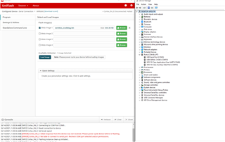

  • am struggling with  Execute the Compiled Lab   Debug mode   i followed
    Using CCS Debug for Development
    Hardware Setup for Flashing in MMWAVEICBOOST Mode
    attached screenshot
    Flash the EVM using UniFlashselection device in uniflashfailed flash device my setup
    the uniflash  does not open uart
    please advice

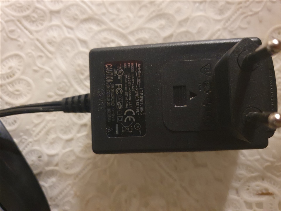

    1. Can you please provide the specs for your power supply to the board. I don't think that is the issue but lets make sure that you have the correct specs.
    2. Also are you plugging your USB cable directly into your PC or are you using a USB hub or something similar?
    Connor Desmond
  • Hi,  one time I sucsses enter with debug (scan area example) mode CCS 8.3.1 since then failed every time
    All the times I trying to connect indebug mode was with hub
    I never sucsses flash boost+isk board the debug file as recommended in tutorial only when iwr6843 is stand alone also in this setup thrush cable was connect via hub
    I could check tommrow without  hub and let you know
    Attached power supply screenshot
  • Zachar:
    Power supply appears to be in line with the user's guide so lets assume that it working as expected. Now how you tried using a different USB cable?
    Connor Desmond
    when flash  foloowing bin : C:\ti\mmwave_sdk_<ver>\packages\ti\utils\ccsdebug\xwr68xx_ccsdebug.bin
    in uniflash  which device i shuld choose   attached screenshot
    when i press start  it never finish the operation
    or  when trying to flash it does not open port ?
    it is not clear what need to choose in uniflash  please elaborate

    You need to choose the IWR6843 device when flashing with Uniflash.
    Connor Desmond

    Seems like you started with custom code + run time error, but the last few steps for debug seem related to Flashing step.
    Can you please help us understand  where you need help and which steps are known to be working from below:
    1.   Able to flash OOB (or Areas scanner) image provide by TI and run the image + GUI
    2.  Able to compile OOB  (or Area scanner)  code as provided  by TI and  confirm it runs on the device.
    3.  Load the image in step #2 via flash method  and confirm working.
    4.  Make code changes  -> compile/create image -> user the new image to run
    Based on this we will guide you, please note that  custom code changes would be hard to debug.
    We will only be able to guide you  in the right direction for going
    Thank you,
    Vaibhav
  • 1. able flash  with uniflash 68xx_mmwave_sdk_dsp.bin or Area scanner.bin   in setup   iwr6843ISK board  standalone  and run Labs with TI tools
    2 Able to compile OOB  (or Area scanner)  code as provided  by TI and  and flash confirm it runs on the device. iwr6843ISK board  standalone  and run Labs with TI tools
    3. falied flash  68xx_mmwave_sdk_dsp.bin or Area scanner.bin  MMWAVEICBOOST + iwr6843ISK board   - not important but   the same behavior applay when i want flash xwr68xx_ccsdebug.bin   in order   run CCS debug   68xx_mmwave_sdk_dsp or Area scanner  project
    my request  is  :   i want run developer  setup CCS debug project ( 68xx_mmwave_sdk_dsp or Area scanner)   original code  not custom code
    i follow  all instruction ( TI Resource  in CCS 8.3.1 )  but   i could not preform flash xwr68xx_ccsdebug.bin   with uniflash  there for  i could not continue the setup
    my opinion  is that MMWAVEICBOOST    board  always in boot  stage  whatever SOP2  in  short  or not
    i want run project OOB or Area scanner   in CCS debug mode   and run Lab   that  is my request my custom code is next step .........

    1) how to flash ccsdebug file in MMWAVEICBOOST + iwr6843ISK    setup
    and run debug  load mss and dss files
  • Just like you flash OOB demo.
    Can you please confirm you can flash the CCSdebug bin on the device.
    Thank you,
    Vaibhav
  • yes   i enable programming IWR6843  standalone  without boost board  after this i was enable enter debug mode in ccs 8.3.1
    the option  MMWAVEICBOOST + iwr6843ISK    does not  work
    i want customize DSP demo   in several ways    i want add param  which  will be send via ctg file  which creating via TI tools
    i want count frames in dsp processes     in send to  cortex4r    and return to  uart interfce to PC   is there  any guide  or white paper to costomize DSP  SDK example ?
  • Zachar:
    So to summarize what you have told me: You can flash the device in stand alone mode, but you can not flash the device when you have it mounted onto the MMWAVEICBOOST. You have made sure that the SOP2 jumper was connected when flashing and not connected when not flashing. You have also verified that you are using the correct power supply and have provided pictures of your MMWAVEICBOOST showing that the switches on the MMWAVEICBOOST are in the correct state per the user guide.
    Please note if any of these statements are incorrect or if there is any other additional information that should contextualize your problem.
    Connor Desmond
  • Hello
    I clicked on Suggest answer by mistake so please ignore that.
    Can you please confirm if you can :
    1. Flash the image in standalone mode
    2. Connect to CCS via  mmwave iceboost mode
    THank you,
    Vaibhav
    You mentioned a python application earlier, can you confirm that the UART ports are not connected to this application while you try to connect to the MMWAVEICBOOST for flashing using UNIFLASH.  Can you try this on a different PC to be sure?
    Also were you able to consistently and successfully flash with MMWAVEICBOOST initially or did this issue start right after unboxing?
    Charles O
  • what is the definition of  mmwave iceboost mode      where i could find explanation ?  could you send link ?
  • i was able successfully  flash MMWAVEICBOOST+ ISK   after this  time it always failed
    the UARTS port are free  hen i am trying to flash  MMWAVEICBOOST+ISK
