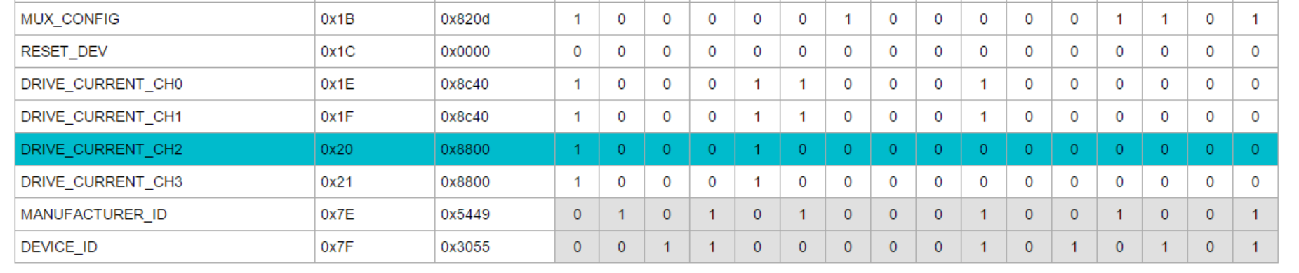

1. When I go to check the value of the registers, vaue of register "DRIVE_CURRENT_CH2"  is "0x8800" while values of register  "DRIVE_CURRENT_CH0" and register "DRIVE_CURRENT_CH1" are both "0x8c40". why are these registers' values  different? Does it influence  the sensor although the drive current is same?

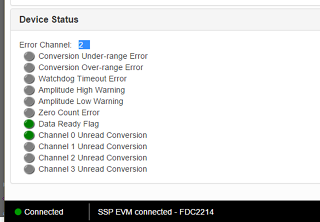

2.In the "Configuration" screen ,"Error channel: 2" is displayed below "Device Status" bar. Is there any error in channel 2?
   I can't find any information about this in the FDC2114 and FDC2214 EVM User’s Guide.Then, how to solve it?

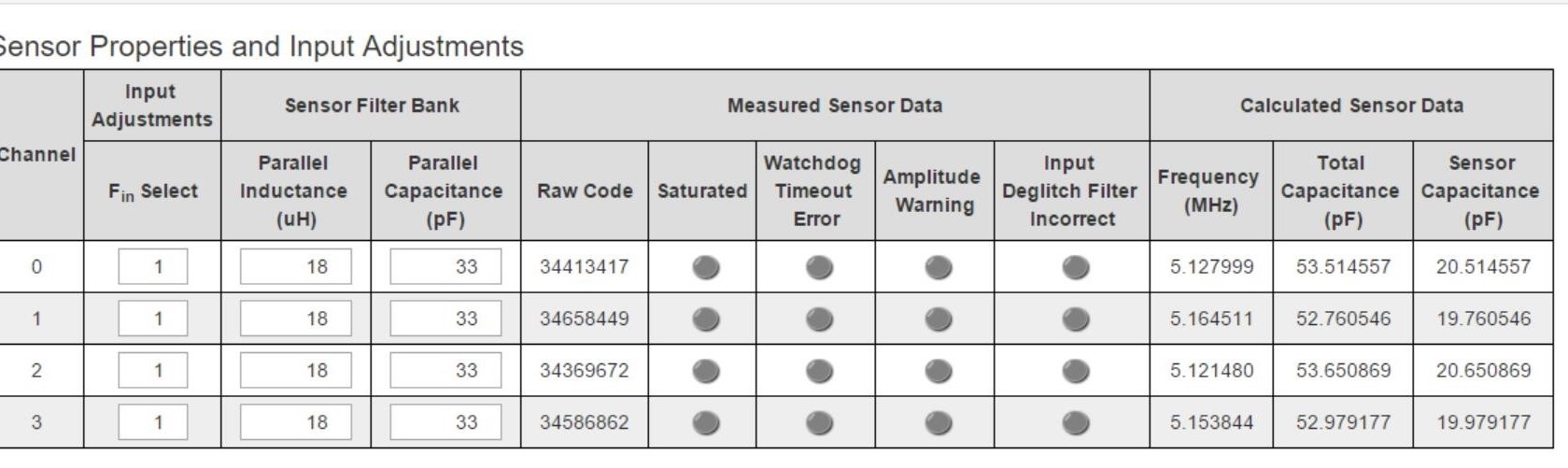

3.After I remove the copper circle from channel 2,the raw code of channel 2 is as same as  without removing it. How to explain it? And I find that channel 2 shows a parasitic capacitance of about 20 pF regardless of which sensor is connected or not. Is this correct?

    1. I checked the default register settings on my FDC2214 EVM, and channels 1-4 all have the same setting.
      The register entries must have been revised.
    2. The FDC2214 sensor is based on a resonating LC circuit formed by 18uH on-board inductors and the capacitance of the sensor. The frequency of the tank circuit must be within 10kHz to 10MHz. The Q of the circuit - or its equivalent effective parallel resistance - coupled with the drive current, will determine the amplitude of the resulting sensor waveform. If the amplitude is too low or too high, it will generate an error. If the frequency is too high or two low, an error will result. This is probably what you are seeing. Please see the FDC2x1x Capacitive Sensing FAQs on this forum's landing page for more detailed information. The app notes shown in the section Inductive Sensing App Notes With Useful Info... may be helpful.

    1. I reset this EVM ,however ,the default register settings is the same as what it is before I reset it. As shown below, the default values of channel 0 and 1 are 0x8c40 while the default values of channel 2 and 3 are 0x8800.
    Why is this default value different from what you said?
    Which value should these registers be changed to? 0x8c40 or 0x8800?

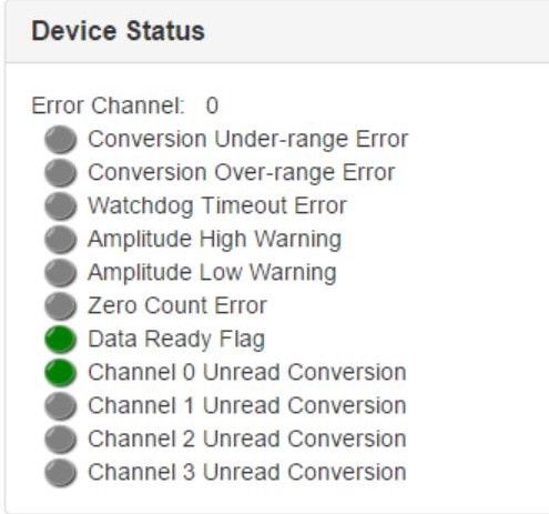

    2.I discovered a new problem with the "Device Status".
    When I choose "Repeat single channel measurement" and check channel 0, "Error Channel:   0" appears below Device Status bar.
    When I check both channel 0 and 1,"Error Channel:   1" appears below Device Status bar.
    When I check  channel 0 , 1 and 2 ,"Error Channel:   2" appears below Device Status bar.
    When I check  all channels ,"Error Channel:   3" appears below Device Status bar.
    Why is it ? And I can't get more information about it .
    As shown above, "Amplitude high warning" and "Amplitude low warning" are grey.Does it mean the amplitude is not too high or too low? Which specific frequency is the frequency you said above ?What should I do to determine if the frequency is too high or too low?And I don't change other parameters in the software.

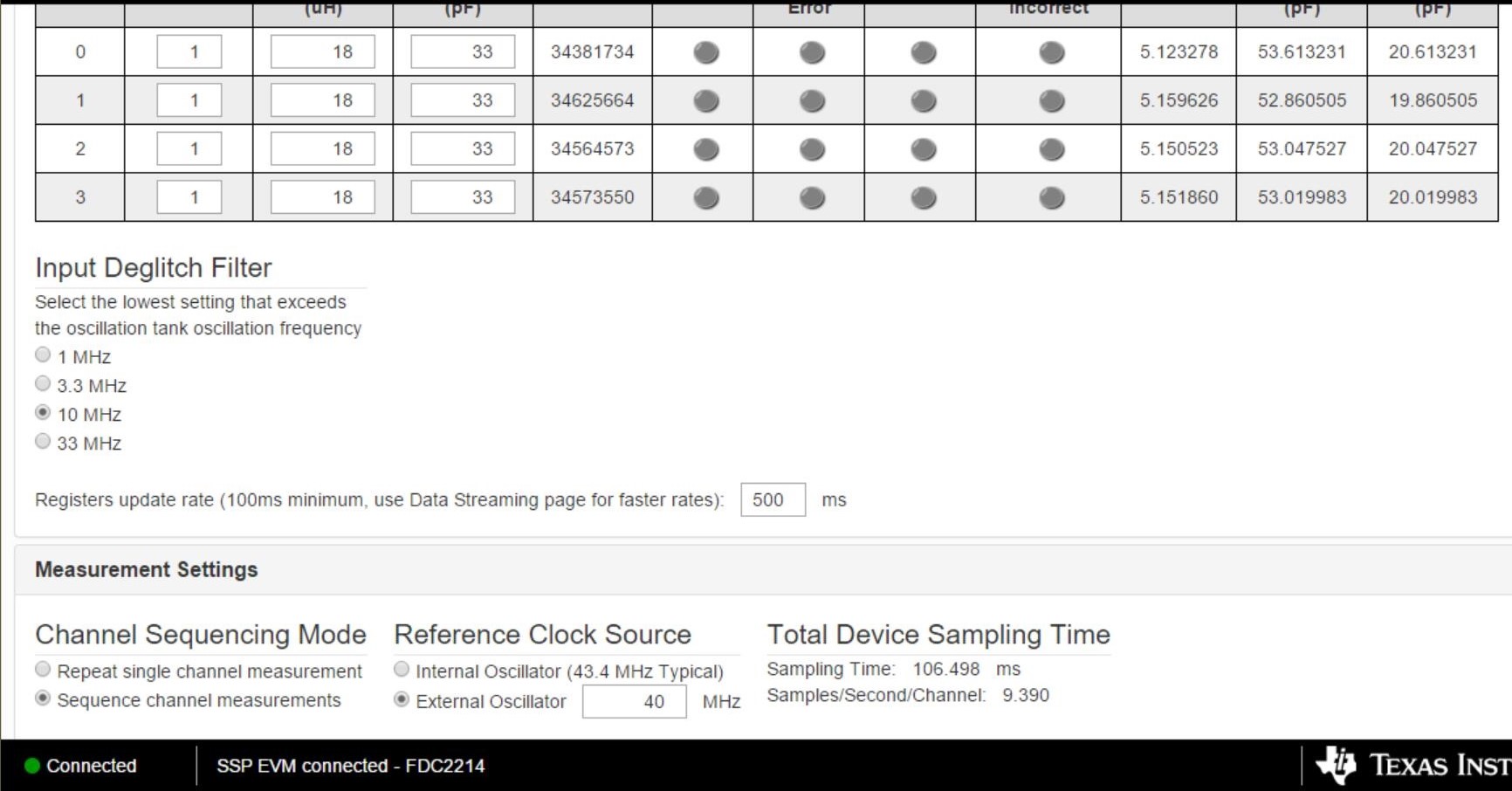

    When I connect homemade sensor(seen above) to channel 2,sensor capacitance is about 20.65pF.
    After I disconnect it ,sensor capacitance is about 20.05pF.
    The capacitance difference is about 0.6pF. Is it  normal ?

    1. The most likely thing that happened was that a new register value was saved to the EVM.
    2. Please try probing the sensor circuit with a high impedance probe and noting if the measured signal falls within the range given in the data sheet. If the signal frequency is too high or too low, it could trigger the Unread error you are seeing.

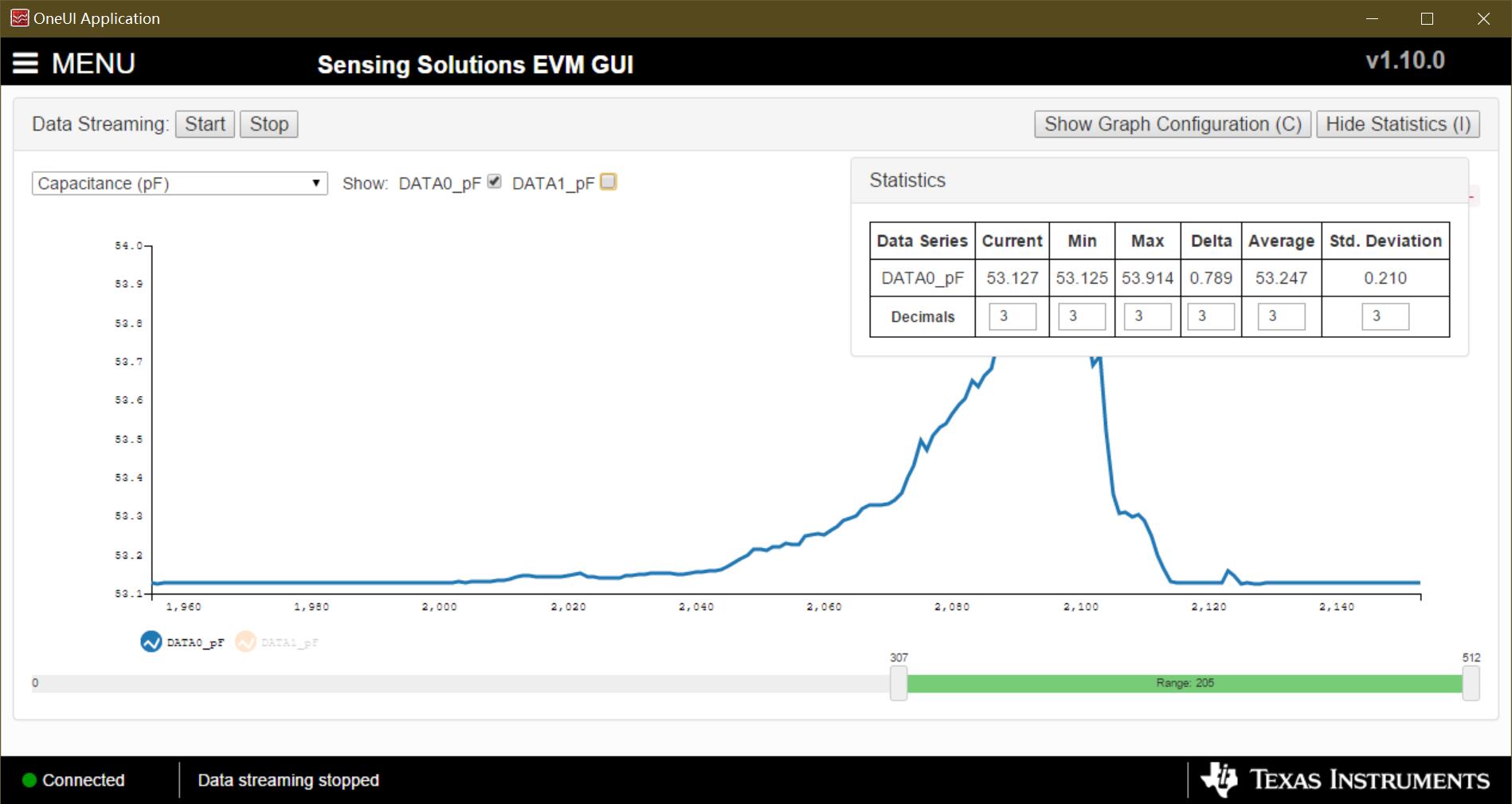

  • I did a simple experiment with one onboard sensor on the FDC2214EVM.
    The sensor's size is 20.9mm×13.9mm,which should be able to achieve proximity sensing  at distances greater than 17cm according to TI's datasheet.
    I used an aluminum sheet as the target object to approach the sensor (the area of the aluminum sheet is larger than the sensor), but even if I put the  sheet very close to the sensor (less than 1cm, but not touch the sensor), the maximum capacitance change shown by the Sensing Solution EVM GUI is only 0.789pF, which does not meet the requirement of 10% (i.e. about 2pF).
    Why is it?
  • It most likely is a function of your sensor and the device settings.
    You will need to experiment with your device settings to get the results you are looking for.
