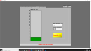

In GUI liquid level is not being changed.
Part Number: TDC1000
Other Parts Discussed in Thread: TDC7200
I need to measure water level in my container.
I followed the below link,
https://www.element14.com/community/groups/roadtest/blog/2015/12/17/ti-ultrasonic-sensor--set-the-parameters-for-level-and-content-measurement
I adjusted the parameters in webench(max level 0.5m and min level is 0.2m ) and downloaded the register file.
later I found that I got errors when loading the register file into GUI app and followed the instructions given in below link,
1. I am using latest GUI version and also tried the modified register values posted in the below link. It loads in the GUI without issues but when you press graph nothing changes.
2. Later I downloaded the register values for SMD10T21R111WL  and loaded them(as per the another option mentioned in the below link) but still facing error as tank is empty when it is partially filled.
https://e2e.ti.com/support/sensors/f/sensors-forum/478399/tdc1000-tdc7200evm-errors-when-importing-register-file-generated-by-design-tool/1732911
need assistance,
I am adding images of the setup,
Hari Charan.

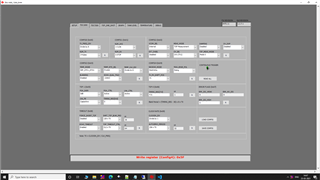

    Additionally, would it be possible for you to provide your device register settings?
    Scott
    My transducer is mounted to the container at its bottom and there is no gap between the transducer and container.
    I am attaching the device register settings,
    Hari Charan.

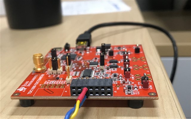

  • Hello Hari,
    I attached my device register settings used for ~7cm of water. Please try these on your EVM with a comparable amount of water to ensure there is not any other issues with the setup.
    This is where the transducer was connected as you can see TX1 is selected on the register setting, the yellow wire with the red tape is the hot lead of the transducer and the blue is the ground. I hope this works for you!
    Isaac
    I changed TDC1000 and TDC7200 register settings as per your images. but my tank is showing empty of ~8cm water level. I am attaching the images required.
    Hari Charan.
  • Hari,
    Thank you for the pictures. It looks like the transducer is not mounted correctly based on your image. Remember the goal is to completely cover the transducer. I have attached a picture and you may reference this App Note  under section 2.3 to learn more about how to mount a transducer. Let me know if that worked!
    Isaac
