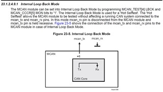

Hi Expert,
- mcanLoopbackTest() can detect signal
- mcanTransmitTest() and mcanEVM_EVMTest() can not detect signal only can detect as below pic

mcanLoopbackTest does Loopback through internal or external you can select in the code.
mcanTransmitTest() and mcanEVM_EVMTest() are the functions designed for transmit and receive using external CAN devices or PC based CAN tool like PCAN on the CAN network.
