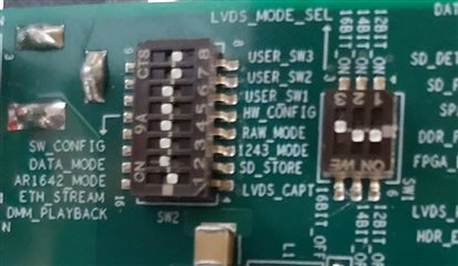

I have a AWR1642 with a DCA1000 EVM module, and I'm trying to run the RadarAPI module under mmWave studio 2.1.1.0.
I have done the following:
  • Checked that it's ES2.0 (and mmWave studio is 2.1.1.0)
  • Formatted the SFLASH using uniflash
  • Connected the jumpers SOP0 and SOP1, leaving SOP2 open
  • Power cycle reset etc
As can be seen in Figure below, everything is successful up to the SPI connect part, after which it throws an error saying
[00:28:53] Status: Failed, Error Type: RESP TIMEOUT
[00:28:57] MSS Power Up async event was not received!
I'm wondering if I setup my hardware incorrectly? The switches on the DCA are shown below:
