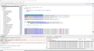

Hello Champs,
I met the same build error when I rebuilt the 64xx_gesture_and_presence_det project as below e2e post.
https://e2e.ti.com/support/sensors/f/sensors-forum/970638/iwr6843isk-gesture_and_presence_det_64xx_mss-error
I checked the C:\ti\mmwave_industrial_toolbox_4_6_0\labs\common\src\dpu\trackerproc\trackerproc.h file. There is no filed for  "presenceParams" as the error message showed. Is the trackerproc.h wrong?

  • Hello Shine,
    There appears to be a bug in the projectspec file that points to the wrong trackerproc folder. This will be fixed in an upcoming toolbox release, but you can update your copy quickly.
    In "C:\ti\mmwave_industrial_toolbox_4_6_0\labs\gesture_recognition\64xx_gesture_and_presence_det\src\64xx_gesture_and_presence_det.projectspec"
         Replace line 32 with "-I${GESTURE_PARENT_DIR}/common/src/dpu/trackerproc_overhead"
         Add a new line beneath line 42 with "-DUSE_TRACPROC_OVERHEAD_DPU"
    Delete the project from your CCS workspace and re-import from the projectspec file and it should build again.
    Jackson
