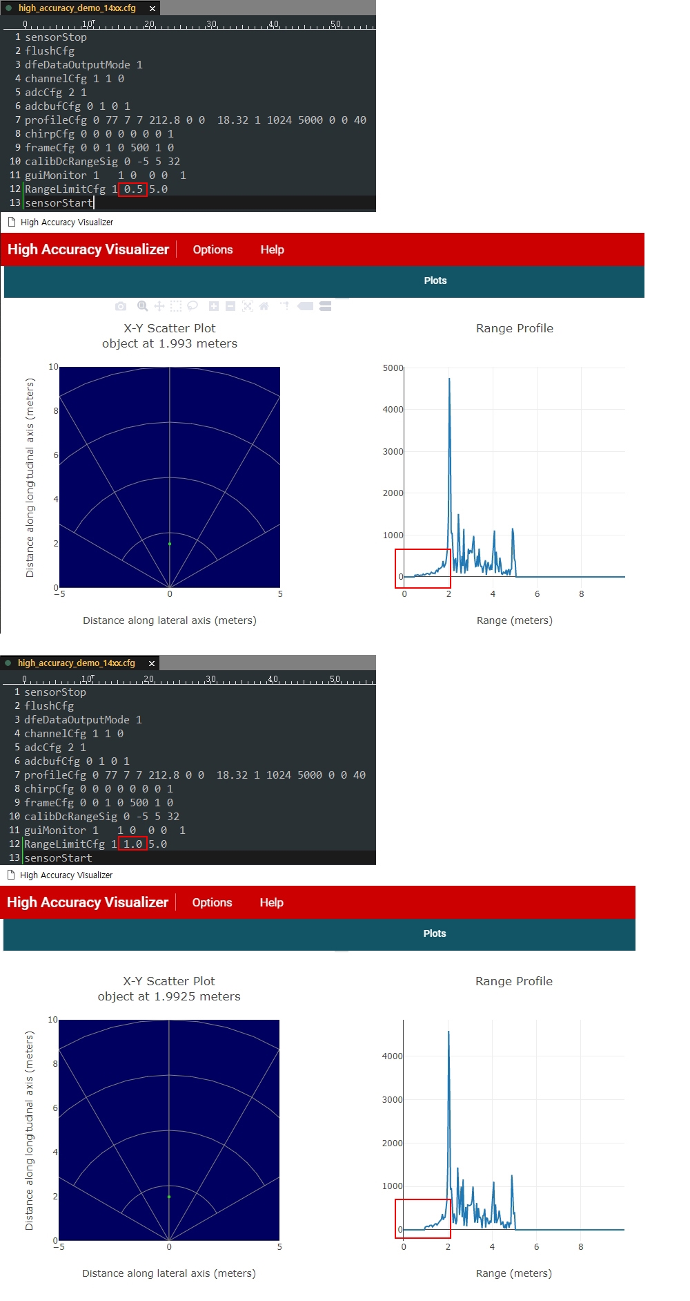

I am experimenting with IWR1642, IWR1443
The figure below is a screenshot of the screen displayed in High_Accuracy_Visualizer 1.2.0.
- IWR1642BOOST
- IWR1443BOOST
I am testing the level_sensing of mmwave_industrial_toolbox_4_6_0.
IWR1642BOOST's RangeLimitCfg was changed.
However, there is no change in the FFT graph displayed in the Range Profile.
IWR1443BOOST's RangeLimitCfg was changed.
The FFT graph displayed in the Range Profile changes the min range according to the value defined in high_accuracy_demo_14xx.cfg.
High_Accuracy_Visualizer 1.2.0. Please let me know if it displays differently.
What is the meaning of RangeLimitCfg 2 1 1.0 3.0 in the contents of high_accuracy_demo_16xx.cfg?
RangeLimitCfg
2 : ???
1 : ???
1.0 : min range
3.0 : max range
thanks

  • Thank you for answer.
    I asked 2 questions
    1. RangeLimitCfg has been resolved.
    2. High_Accuracy_Visualizer 1.2.0 issue is not resolved
    Please check the picture included in the question and answer it.
    Regards.
    lee
  • Hi Lee
    The Range Limit Cfg feature in the 16xx and 68xx versions of the lab simply specify the zone of interest to perform the zoom FFT.
    The 14xx and 64xx versions of the lab actually remove bins outsize the zone of interest for the 1D FFT.
    AG
