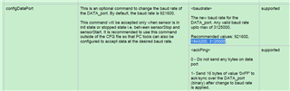

According mmwave sdk user guide instructions, uart baudrate can support 1843200, 3125000 bps.
We modified source code and set baud rate to 18432000 or 3125000,  Setting the same baud rate(18432000/3125000) on the PC side cannot receive uart data.

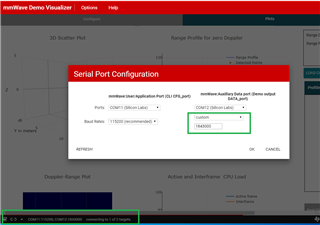

We use mmwave demo visualizer tool to configure rader and set uart baud rate to 1843000 or 3125000,the radar waveform is also not displayed.

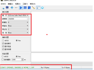

    We tested 1843000 and 3125000 baud rates with the serial port debugging tool or Python APP, but we still did not receive the data sent by UART. If the baud rate is set to 921600 BPS, we can receive the data from UART, so please confirm the maximum supported baud rate, thank you.

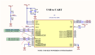

    We use cp2105 usb-to-dual uart bridge, Standard UART  baudrate max is 9216000 bps, enhanced UART baud rate is 300 bps to 2.0 Mbps.
    As you know iwr6843 demo code default UART(SCI) Logging Baud Rate is set to 921600, UART(ECI) Command Baud Rate is set to 115200, if we swap these two uart baud rates, is this ok?
    It should be OK. you can do a quickly test with set the command UART port to <2Mbps baudrate.

    I have another question to confirm:
    The  schematic diagram RADAR_MSS_LOGGER(PAD F14) is connected to RXD_SCI of CP2105 ,USB_AR_rs232_TX (PAD N5)is connected to RXD_ECI, and USB_AR_rs232_RX (PAD N4)is connected to TXD_ECI .
    According to the instructions of CP2105, only Enhanced UART's bauder rate can support 2Mbps, so we need to connect RADAR_MSS_LOGGER to RXD_ECI. Currently, there is no way to modify the hardware. How to modify the software so that the baud rate of RADAR_MSS_LOGGER can support 2Mbps.
  • Hi ,
    You dont need to swap these pin in Hardware, Please do it in software.
    You can use single N4N5 uart for all the things. and it support 2Mbps on ISK board
    What you need to do is modify the communication protocol code by youself.
    And, current demo and sdk driver only use MSS_LOGGER UART's TX pin, if you want to use this to receive something from PC, you need to modify the SDK driver and pinmux.
    Thanks.
    Regards.
    Wesley
