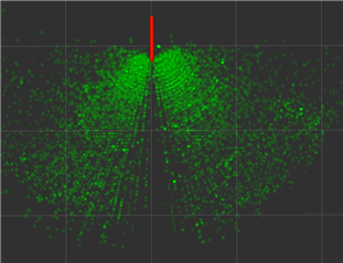

Hi, I am looking at IWR6843 isk-ods using the ROS diver.
I am on a moving platform and I have noticed the following: Detection are rear stright infront of the sensor. Even when I put reflectors there.
The picture shows all detections from a run during 1 min.
Question 1: Why is this? The lobe of the antenna is the strongest here and the angular resolution should be the smallest.Is there a physical explanation or how to fix this? or is it boundry effects in fft?
Question 2: I have noticed that ROS does not have IWR6843ISK-ODS cfg. We will evaluate IWR6843AOP, Will this be present there as well?

    Thank you for collecting this data. Answering your questions in order:
    1. The image clearly shows fewer points at boresight. I will take an action to discuss this internally and post back to you. If you have a ISK (non-ODS), could you re-do the experiment to show the differences? The ODS board was designed to have a wider field-of-view compared to ISK.

  • Hi, No I do not have the isk antenna but I can see from promotion videos its not present. Perhaps it is present but due to better resolution in azimuth its clearly visable. Please hava a look, it is quite clear. My question is why and more importantly, is this effect present on the AOP?

    Thank you for posting back, this is helpful. I was referring to the first image you posted, where you run the device for 1 min. Could you post some steps for that?
    Did your tests improve after doing the calibration steps?
  • The first test is the same setting but I plot all points during 1 min. So if you want to reproduce, launch the ROS driver.
    1) Choose your radar frame in rviz
    2) Set Decay time in pointcloud2 massege to a huge number, 5000 sec.
    3) Collect the points (preferably indoors) by constantly moving and rotating the radar towards various objects. The longer time you do this the more visible it is.
    It is actually even more visible by doing:
    Point radar towards an object with free space around it, and rotate the radar. You will then see all points on a circle with distance X but detections are weak and few straight ahead. This is the last video/images I sent.

  • Hi Amir,
    I am now understanding what your problem is. bpmCfg is failing because you have used incorrect profile_calibration.cfg.
    You used profile_calibration.cfg from 68xx directory. You need to use from 64xx directory.
  • Thanks, I will try flash and get back to you
  • Hi, I did the calibration and it did the trick.
    Now I get weaker signatures on the sides, as expected.
