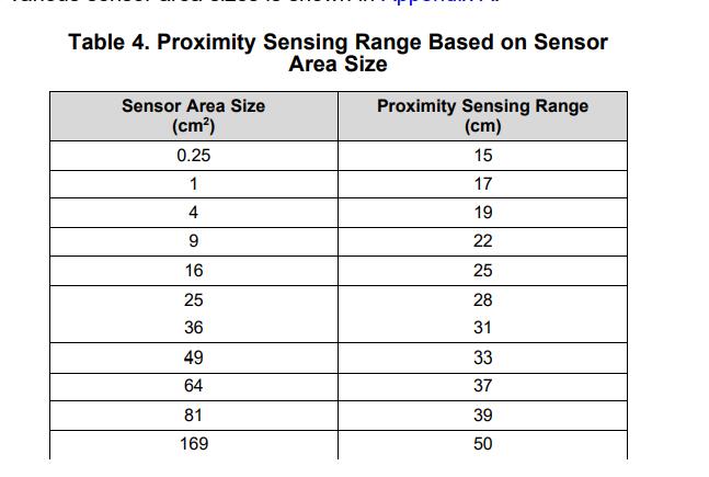

I have seen from the information introduction of Texas Instruments that the maximum induction distance of the current capacitive approach can reach 70 cm.
Although I do not remember which data manual this is mentioned in, I clearly remember the figure of 70 cm.
Could you please tell me how to achieve it?
Is this a theoretical figure or is Texas Instruments already a real one?  If it's the latter, I wonder if TI has a reference design or even a final product?
