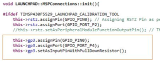

Hello experts,
we are using the OPT3101evm board.
We would like to configure an output pin,  e.g. GP3 at connector J19, as input. The input should be used to start capturing a measurement in Latte.
To do so, we downloaded the SDK and changed the pin configuration with CCS.
Now, we have a .txt and an .out file.
The documentation SBAU309A–February 2018–Revised June 2018 gives not a very detailed description on how to flash the new firmware:
So, we pushed the button and tried different things.
CCS gives an error "No USB FET was found".
Latte gives an error "OPT3101EVM Connection Problem".
We have no idea, how to get the firmware on the EVM.

  • Hi Steffen,
    OPT3101EVM stores important calibration parameters in the MSP flash. If you flash the EVM these parameters would be overwritten and EVM would not be functional so we do not really support this. Are you looking to redo the full calibration using the SDK and have a good idea of this process? Additionally, SDK will not work with the EVM GUI software and has a separate interface.

  • Hi Steffen,
    That is correct, SDK is not compatible with the latte software. What do you mean by connecting another sensor? What sensor is this and do you mean adding another sensor on the I2C bus in addition to OPT3101?
