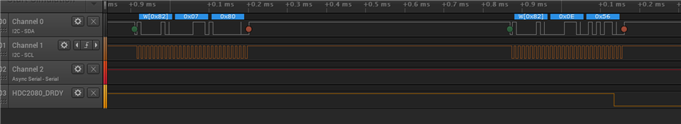

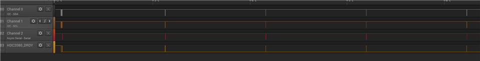

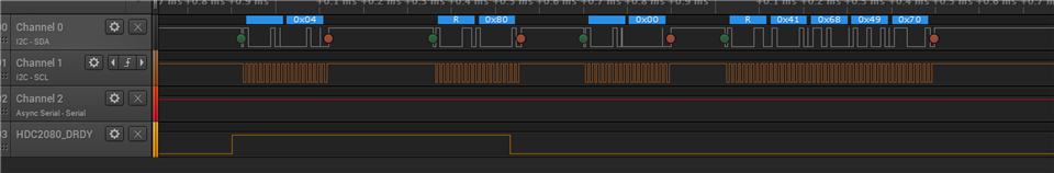

  • Dear Andy -
    The way that works is that once you configure the part, you still need to tell it to start converting one time, to start it.
    configuring part
    sending the start conversion (just once), getting first IRQ and servicing
    then only IRQs following (zoom)
    overall (showing first and subsequent IRQs, zoomed out)
