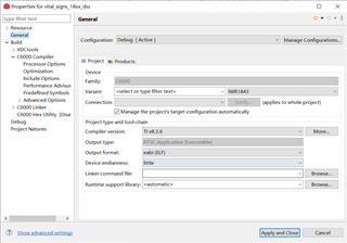

I'm trying to run the Vital Signs Demo of xWR6843 from Industrial Toolbox 4.6 using IWR1843,in the CCS project, the following changes have been made:
1.Change the Variant in the properties of the dss file and mss file to IWR1843:
But I cannot change the Linker command file to: xwr1843_C674x.cmd, otherwise it will fail to compile.I want to ask how should I change it?
