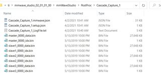

I'm working on AWR1243 cascade board. It is configured by mmWaveStudio(tried with version 2.1.1.0 & version 2.1.0.0) in GUI mode. In the capture section, after Triggering the frame, I'm not able to see the captured files and it is giving an error "The number of files captured in the directory is zero! Nothing to transfer! " . I have checked with the FPGA CDONE LEDs on the back of the MMWCAS-DSP-EVM PCB and it is glowing. Binary files are not generated in the SSD itself. Requesting your support for resolving this issue.

    Could you send us your mmWave Studio output log here? That would help us understand your sequence.

  • Hi Ishita, here is the mmwave studio output log.
    GM: Constructor
    GM: Wed Mar 31 11:32:41 2021
    RSTD.Transmit("/Settings")
    [11:32:41]
    [11:32:41] ### Running Startup script: "C:\ti\mmwave_studio_02_01_00_00\mmWaveStudio\Scripts\Startup.lua" ###
    [11:32:41] RSTD.SetAndTransmit ("/Settings/Scripter/Display DateTime" , "1")
    [11:32:41] RSTD.SetAndTransmit ("/Settings/Scripter/DateTime Format" , "HH:mm:ss")
    [11:32:41] Scripter ignored: Attempt to UnBuild() again or before Build.
    [11:32:41] RSTD.SetVar ("/Settings/Clients/Client 0/Dll" , "C:\\ti\\mmwave_studio_02_01_00_00\\mmWaveStudio\\Clients\\\\LabClient.dll")
    [11:32:41] RSTD.SetVar ("/Settings/Clients/Client 0/Use" , "TRUE")
    [11:32:41] RSTD.SetVar ("/Settings/Clients/Client 1/Use" , "FALSE")
    [11:32:41] RSTD.SetVar ("/Settings/Clients/Client 2/Use" , "FALSE")
    [11:32:41] RSTD.SetVar ("/Settings/Clients/Client 3/Use" , "FALSE")
    [11:32:41] RSTD.SetVar ("/Settings/Clients/Client 4/Use" , "FALSE")
    [11:32:41] RSTD.SetVar ("/Settings/AL Client/AL Dll" , "C:\\ti\\mmwave_studio_02_01_00_00\\mmWaveStudio\\RunTime\\SAL.dll")
    [11:32:42] RSTD.SetVar ("/Settings/Clients/Client 0/GuiDll" , "")
    [11:32:42] RSTD.SetVar ("/Settings/AutoUpdate/Enabled" , "TRUE")
    [11:32:42] RSTD.SetVar ("/Settings/AutoUpdate/Interval" , "1")
    [11:32:42] RSTD.SetVar ("/Settings/Monitors/UpdateDisplay" , "TRUE")
    [11:32:42] RSTD.SetVar ("/Settings/Monitors/OneClickStart" , "TRUE")
    [11:32:42] RSTD.SetVar ("/Settings/Automation/Automation Mode" , "false")
    [11:32:42] RSTD.Transmit("/")
    [11:32:42] RSTD.SaveSettings(): Settings saved to "C:\Users\Sandeep Maiya\AppData\Roaming\RSTD\config.xml"
    [11:32:42] RSTD.Build()
    [11:32:42] RSTD.AL_Build()
    [11:32:42] RSTD.AL_LoadXml()
    [11:32:42] RSTD.AL_Init()
    [11:32:42] RSTD.Clients_Build()
    [11:32:42] GM: Init
    [11:32:42] GM: Loaded 'C:\ti\mmwave_studio_02_01_00_00\mmWaveStudio\Clients\\LabClient.dll'
    [11:32:42] GM: 1 Guest (s) init
    [11:32:42] GM: 1 Module(s) init
    [11:32:42] GM: 2 Tab (s) init
    [11:32:42] RSTD.Client_LoadXml()
    [11:32:42] [RadarAPI]: ar1.selectRadarMode(0)
    [11:32:42] [RadarAPI]: Status: Passed
    [11:32:42] Matlab Runtime Engine is installed
    [11:32:42] [RadarAPI]: Starting Matlab Engine..
    [11:32:49] [RadarAPI]: Matlab Engine Started!
    [11:32:51] [RadarAPI]: ar1.selectCascadeMode(0)
    [11:32:51] [RadarAPI]: Status: Passed
    [11:32:51] [RadarAPI]: ar1.LoadSettings('C:\Users\Sandeep Maiya\AppData\Roaming\RSTD\ar1gui.ini')
    [11:32:52] TESTING = false
    [11:32:52] RstdNet: Port 2777: Listening..
    [11:32:52]
    [11:32:52] ***Script completed successfully.***
    [11:33:04] [RadarAPI]: ar1.selectRadarMode(1)
    [11:33:04] [RadarAPI]: ar1.selectCascadeMode(1)
    [11:33:04] [RadarAPI]: Status: Passed
    [11:33:05] [RadarAPI]: ar1.SelectCaptureDevice("TDA2XX")
    [11:33:05] [RadarAPI]: Status: Passed
    [11:33:07] [RadarAPI]: TDAStatusCallback Event Registered
    [11:33:07] [RadarAPI]: registerTDAStatusCallback Status: Passed
    [11:33:07] [RadarAPI]: ar1.ConnectTDA("192.168.33.180", 5001, 15)
    [11:33:07] [RadarAPI]: Device 32 : CAPTURE_RESPONSE_ACK Async event recieved() with status 0
    [11:33:07] [RadarAPI]: Device 32 : CAPTURE_RESPONSE_VERSION_INFO Async event recieved() with status 0. TDA Version : REL_VISION_SDK_03_07_01_00 Aug 5 2019 15:04:45 �
    [11:33:09] [RadarAPI]: Device 1 : CAPTURE_RESPONSE_ACK Async event recieved() with status 0
    [11:33:09] [RadarAPI]: ConnectTDACaptureCard Status: Passed
    [11:33:09] TDA Capture Card Status : CONNECTED!
    [11:33:12] [RadarAPI]: Device 1 : CAPTURE_RESPONSE_ACK Async event recieved() with status 0
    [11:33:13] [RadarAPI]: ar1.FullReset(1)
    [11:33:13] [RadarAPI]: Status: Passed
    [11:33:13] [RadarAPI]: ar1.SOPControl_mult(1,4)
    [11:33:15] [RadarAPI]: ar1.PowerOn_mult(1, 0, 1000, 0,0)
    [11:33:16] [RadarAPI]: Status: Passed
    [11:33:16] [DeviceId-0] MSS power up done async event received!
    [11:33:18] [RadarAPI]: ar1.DownloadBSSFw_mult(1,"C:\\ti\\mmwave_dfp_01_02_05_01\\firmware\\xwr12xx_metaImage.bin")
    [11:33:18] [RadarAPI]: ar1.DownloadBssFwOvSPI_mult(1, C:\\ti\\mmwave_dfp_01_02_05_01\\firmware\\xwr12xx_metaImage.bin)
    [11:33:33] [DeviceId-0] MSS Boot Error status Async event recieved(0x1672BE)
    [11:33:36] [RadarAPI]: ar1.SelectChipVersion("AR1243")
    [11:33:36] [RadarAPI]: Status: Passed
    [11:33:36] [RadarAPI]: ar1.deviceVariantSelection("XWR1243")
    [11:33:36] [RadarAPI]: ar1.frequencyBandSelection("77G")
    [11:33:36] [RadarAPI]: ar1.SelectChipVersion("XWR1243")
    [11:33:36] Device Status : XWR1243/ASIL-B/SOP:4/ES:3
    [11:33:36] [RadarAPI]: ar1.RfEnable_mult(1)
    [11:33:36] [DeviceId-0] BSS power up done async event received!
    [11:33:51] [RadarAPI]: ar1.ChanNAdcConfig_mult(1, 1, 1, 0, 1, 1, 1, 1, 2, 1, 0, 1)
    [11:33:51] [RadarAPI]: Status: Passed
    [11:33:52] [RadarAPI]: ar1.LPModConfig_mult(1, 0,0)
    [11:33:52] [RadarAPI]: Status: Passed
    [11:33:53] [RadarAPI]: ar1.RfInit_mult(1)
    [11:33:53] [DeviceId-0] RF Init async event received!
    [11:33:53] [RadarAPI]: Status: Passed
    [11:33:53] [RadarAPI]: Time stamp, Temperture: 17072,39; APLL Status, Update: 1, 0; SynthVCO1 Status, Update: 1, 1; SynthVCO2 Status, Update: 1, 1; LODist Status, Update: 1, 1; RxADCDC Status, Update: 1, 1; HPFcutoff Status, Update: 1, 1; LPFcutoff Status, Update: 1, 1; PeakDetector Status, Update: 1, 1; TxPower Status, Update: 1, 1; RxGain Status, Update: 1, 1; TxPhase Status, Update: 1, 1; RxIQMM Status, Update: 1, 1;
    [11:34:03] [RadarAPI]: Device 2 : CAPTURE_RESPONSE_ACK Async event recieved() with status 0
    [11:34:04] [RadarAPI]: Device 2 : CAPTURE_RESPONSE_ACK Async event recieved() with status 0
    [11:34:04] [RadarAPI]: ar1.FullReset(2)
    [11:34:04] [RadarAPI]: Status: Passed
    [11:34:04] [RadarAPI]: ar1.SOPControl_mult(2,4)
    [11:34:08] [DeviceId-1] MSS power up done async event received!
    [11:34:08] [RadarAPI]: ar1.AddDevice(2)
    [11:34:08] [RadarAPI]: Status: Passed
    [11:34:22] [RadarAPI]: ar1.DownloadBSSFw_mult(2,"C:\\ti\\mmwave_dfp_01_02_05_01\\firmware\\xwr12xx_metaImage.bin")
    [11:34:22] [RadarAPI]: ar1.DownloadBssFwOvSPI_mult(2, C:\\ti\\mmwave_dfp_01_02_05_01\\firmware\\xwr12xx_metaImage.bin)
    [11:34:37] [DeviceId-1] MSS Boot Error status Async event recieved(0x1672C3)
    [11:34:40] [RadarAPI]: ar1.SelectChipVersion("AR1243")
    [11:34:40] [RadarAPI]: Status: Passed
    [11:34:40] [RadarAPI]: ar1.SelectChipVersion("XWR1243")
    [11:34:40] Slave1 Device Status : XWR1243/ASIL-B/SOP:4/ES:3
    [11:34:41] [RadarAPI]: ar1.RfEnable_mult(2)
    [11:34:41] [DeviceId-1] BSS power up done async event received!
    [11:34:41] [RadarAPI]: Status: Passed
    [11:34:48] [RadarAPI]: Device 4 : CAPTURE_RESPONSE_ACK Async event recieved() with status 0
    [11:34:49] [RadarAPI]: Device 4 : CAPTURE_RESPONSE_ACK Async event recieved() with status 0
    [11:34:49] [RadarAPI]: ar1.FullReset(4)
    [11:34:49] [RadarAPI]: Status: Passed
    [11:34:49] [RadarAPI]: ar1.SOPControl_mult(4,4)
    [11:34:51] [DeviceId-2] MSS power up done async event received!
    [11:34:51] [RadarAPI]: ar1.AddDevice(4)
    [11:34:52] [RadarAPI]: Status: Passed
    [11:34:53] [RadarAPI]: ar1.DownloadBSSFw_mult(4,"C:\\ti\\mmwave_dfp_01_02_05_01\\firmware\\xwr12xx_metaImage.bin")
    [11:34:53] [RadarAPI]: ar1.DownloadBssFwOvSPI_mult(4, C:\\ti\\mmwave_dfp_01_02_05_01\\firmware\\xwr12xx_metaImage.bin)
    [11:35:08] [DeviceId-2] MSS Boot Error status Async event recieved(0x1672AD)
    [11:35:24] [RadarAPI]: ar1.SelectChipVersion("AR1243")
    [11:35:24] [RadarAPI]: Status: Passed
    [11:35:24] [RadarAPI]: ar1.SelectChipVersion("XWR1243")
    [11:35:25] Slave2 Device Status : XWR1243/ASIL-B/SOP:4/ES:3
    [11:35:25] [RadarAPI]: ar1.RfEnable_mult(4)
    [11:35:25] [DeviceId-2] BSS power up done async event received!
    [11:35:25] [RadarAPI]: Status: Passed
    [11:35:31] [RadarAPI]: Device 8 : CAPTURE_RESPONSE_ACK Async event recieved() with status 0
    [11:35:32] [RadarAPI]: ar1.FullReset(8)
    [11:35:32] [RadarAPI]: Status: Passed
    [11:35:32] [RadarAPI]: ar1.SOPControl_mult(8,4)
    [11:35:34] [DeviceId-3] MSS power up done async event received!
    [11:35:34] [RadarAPI]: ar1.AddDevice(8)
    [11:35:34] [RadarAPI]: Status: Passed
    [11:35:36] [RadarAPI]: ar1.DownloadBSSFw_mult(8,"C:\\ti\\mmwave_dfp_01_02_05_01\\firmware\\xwr12xx_metaImage.bin")
    [11:35:36] [RadarAPI]: ar1.DownloadBssFwOvSPI_mult(8, C:\\ti\\mmwave_dfp_01_02_05_01\\firmware\\xwr12xx_metaImage.bin)
    [11:35:51] [DeviceId-3] MSS Boot Error status Async event recieved(0x166F21)
    [11:35:58] [RadarAPI]: ar1.SelectChipVersion("AR1243")
    [11:35:58] [RadarAPI]: Status: Passed
    [11:35:58] [RadarAPI]: ar1.SelectChipVersion("XWR1243")
    [11:35:58] Slave3 Device Status : XWR1243/ASIL-B/SOP:4/ES:3
    [11:35:58] [RadarAPI]: ar1.RfEnable_mult(8)
    [11:35:58] [DeviceId-3] BSS power up done async event received!
    [11:36:12] [RadarAPI]: ar1.ChanNAdcConfig_mult(14, 1, 1, 0, 1, 1, 1, 1, 2, 1, 0, 2)
    [11:36:13] [RadarAPI]: Status: Passed
    [11:36:14] [RadarAPI]: ar1.LPModConfig_mult(14, 0,0)
    [11:36:14] [RadarAPI]: Status: Passed
    [11:36:15] [RadarAPI]: ar1.RfInit_mult(14)
    [11:36:15] [DeviceId-3] RF Init async event received!
    [11:36:15] [DeviceId-1] RF Init async event received!
    [11:36:15] [RadarAPI]: Time stamp, Temperture: 94485,47; APLL Status, Update: 1, 0; SynthVCO1 Status, Update: 1, 1; SynthVCO2 Status, Update: 1, 1; LODist Status, Update: 1, 1; RxADCDC Status, Update: 1, 1; HPFcutoff Status, Update: 1, 1; LPFcutoff Status, Update: 1, 1; PeakDetector Status, Update: 1, 1; TxPower Status, Update: 1, 1; RxGain Status, Update: 1, 1; TxPhase Status, Update: 1, 1; RxIQMM Status, Update: 1, 1;
    [11:36:15] [DeviceId-2] RF Init async event received!
    [11:36:15] [RadarAPI]: Status: Passed
    [11:36:15] [RadarAPI]: Time stamp, Temperture: 50326,53; APLL Status, Update: 1, 0; SynthVCO1 Status, Update: 1, 1; SynthVCO2 Status, Update: 1, 1; LODist Status, Update: 1, 1; RxADCDC Status, Update: 1, 1; HPFcutoff Status, Update: 1, 1; LPFcutoff Status, Update: 1, 1; PeakDetector Status, Update: 1, 1; TxPower Status, Update: 1, 1; RxGain Status, Update: 1, 1; TxPhase Status, Update: 1, 1; RxIQMM Status, Update: 1, 1;
    [11:36:33] [RadarAPI]: ar1.DataPathConfig_mult(15, 513, 1216644097,0)
    [11:36:33] [RadarAPI]: Status: Passed
    [11:36:34] [RadarAPI]: ar1.LvdsClkConfig_mult(15, 1,1)
    [11:36:34] [RadarAPI]: Status: Passed
    [11:36:37] [RadarAPI]: ar1.LVDSLaneConfig_mult(15, 0, 1, 1, 1, 1, 1, 0,0)
    [11:36:37] [RadarAPI]: Status: Passed
    [11:36:44] [RadarAPI]: ar1.ProfileConfig_mult(15, 0, 77, 100, 6, 60, 0, 0, 0, 0, 0, 0, 29.982, 0, 256, 10000, 0, 0, 30)
    [11:36:44] [RadarAPI]: Status: Passed
    [11:36:49] [RadarAPI]: ar1.ChirpConfig_mult(15, 0, 0, 0, 0, 0, 0, 0, 1, 0,0)
    [11:36:50] [RadarAPI]: Status: Passed

    [11:38:07]  [RadarAPI]: ar1.StartMatlabPostProc("C:\\ti\\mmwave_studio_02_01_00_00\\mmWaveStudio\\PostProc\\adc_data2.bin")
    [11:38:07]  [RadarAPI]: No of files Captured: 0, Total no of frames for each device : 8
    [11:38:07]  Error : The number of files captured is zero!
    [11:38:54]  RSTD.ShowLogFile()
    Herewith attached the log file.
    Thank you,
    Vaishnavi
  • Hello Vaishnavi,
    Thanks for your prompt response. I did take a look and I see you're using an older studio and firmware version.
    Can you possibly download the latest mmWave studio package for AWR1243 i.e mmWave studio 02_01_01_00.
    Also, the latest firmware is mmwave DFP_01_02_06_03.
    After upgrading, please try and execute the example scripts for cascade. And make sure to reset the setup a couple of times.
    Let us know your observations.
    Ishita

    Hi Ishita,
    Herewith attached the output log from mmwave studio version 02_01_01_00 and with mmwave_dfp_01_02_06_03. After resetting several times, still it shows the same error.
    Thank you,
    Kind Regards,
    Vaishnavi Rao

    Hello Ishita,
    While trying with Lua script, I observe that the binary files are generated in the specified directory. But in the setup Json file, "numFilesCollected": 0. Herewith attached the output log from mmwave studio and screenshots of the directory and *setup.json file.

  • Hello Vaishnavi,
    Thanks for the trying out the example lua scripts. From your mmWave Studio log, I can see you're able to successfully capture raw data and transfer it to your PC and that is also represented by the file size of master and slave data.bin files.
    Ignore the parameter in the setup Json file.
    I would request you take help from these scripts and build on it further to keep the timing of capture in sync.
    Hope this gets you started now.
