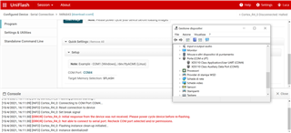

I've just received the IWR6843ISK-ODS eval kit and I'm trying to set up a first demo, the point-cloud demo.
I followed all the steps in the SWRU546D - 60GHz mmWave Sensor EVMs User's Guide, and in the lab description (https://dev.ti.com/tirex/explore/node?node=AHUVfZLNUKWpA43MPJTM7Q__VLyFKFf__LATEST), but after clicking on "load image" in Uniflash, the tool executes the starting scripts and then hangs there, with just a "please wait" notice. No log is in the console.
I browsed various E2E threads, but none of them seem to apply to my situation. All jumpers and switches seem to be in the right position, all software and drivers are updated to the latest version (I'm on Windows 10).
I tried with the IWR6843ISK-ODS both as standalone and attached to the MMWAVEICBOOST (with the proper jumper/switch configuration). The result is the same.
Any hints on how to solve this problem?
I attach two images: my current setting with standalone IWR6843ISK-ODS module, and the screenshot of the Uniflash tool.

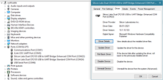

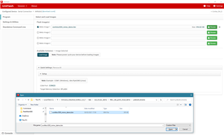

  • Hello Vaibhav and thanks for the reply.
    I checked the points you suggested, but all seems fine (at least to me).
    Here I attach screenshots of the UART port and driver, then of Uniflash with the selected image (it's a precompiled from TI, so I guess it should be ok) and port setting. I used COM ports for many other activities, and so far never had permission problems. So I guess this applies to Uniflash as well.
    I also tried a flash format. Same outcome (i.e. Uniflash hanging - see picture below).
    I managed to extract some logs from Uniflash. I paste them here, after the images.
    As a last information, I noticed that after running and closing Unifllash, there is a task named "Code Composer Studio - Debug Server Lite" that still runs and eats up a lot of CPU. There spawan and remain are as many "CCS - servers" as the Uniflash programs I launch. It seems it remains hanging in the background.
    If you need any further info or tests I can perform, please let me know.
