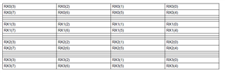

    I use AWR1843 Demo project, found that  ADC Buf configured like this:
   dataFormat.adcOutFormat = 0;
    dataFormat.channelInterleave = 1;/* Sample Interleave must be I(MSB) Q(LSB) for HWA usage. */
    dataFormat.sampleInterleave = 1;

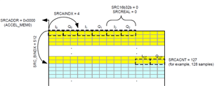

   But I found that AWR1843 is litter endian, channelInterleave = 1 means that ADC data stroed in memory frome low should like:
   in each data Q(imag part) data should be at low address, and I(real part) should be at high address, like:
   Rx0(3)_Q/Rx0(3)_I        Rx0(2)_Q/Rx0(2)_I           Rx0(1)_Q/Rx(1)_I        Rx0(0)_Q/Rx0(0)_I
   But HWA needs I(real part) at low address, and Q(imag part) at high address,
   the configure seems not match HWA input.
