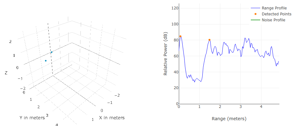

IWR6843ISK: Falsely detected object in front of the radar.
Part Number: IWR6843ISK
Hello, I have the same problem with IWR6843ISK as in this thread besides oxidation https://e2e.ti.com/support/sensors/f/sensors-forum/987095/iwr1443boost-there-is-no[…]-oxidation/3646254?tempkey=b41b3d5e-4c6e-40c5-b20e-a127b4cdc33f.
IWR6843ISK is new.
What is the problem?SDK: 03.05.00.04
Version of mmWave SDK demo: xwr68xx_mmw_demo.bin
mmWave Demo Visualizer: 3.5.0Config:
sensorStop
flushCfg
dfeDataOutputMode 1
channelCfg 15 7 0
adcCfg 2 1
adcbufCfg -1 0 1 1 1
profileCfg 0 60 359 7 57.14 0 0 70 1 112 2279 0 0 158
chirpCfg 0 0 0 0 0 0 0 1
chirpCfg 1 1 0 0 0 0 0 4
chirpCfg 2 2 0 0 0 0 0 2
frameCfg 0 2 16 0 100 1 0
lowPower 0 0
guiMonitor -1 1 1 0 0 0 0
cfarCfg -1 0 2 8 4 3 0 15 1
cfarCfg -1 1 0 4 2 3 1 15 1
multiObjBeamForming -1 1 0.5
clutterRemoval -1 0
calibDcRangeSig -1 0 -5 8 256
extendedMaxVelocity -1 0
bpmCfg -1 0 0 1
lvdsStreamCfg -1 0 0 0
compRangeBiasAndRxChanPhase 0.0 1 0 1 0 1 0 1 0 1 0 1 0 1 0 1 0 1 0 1 0 1 0 1 0
measureRangeBiasAndRxChanPhase 0 1.5 0.2
CQRxSatMonitor 0 3 5 121 0
CQSigImgMonitor 0 55 4
analogMonitor 0 0
aoaFovCfg -1 -90 90 -90 90
cfarFovCfg -1 0 0 3.90
cfarFovCfg -1 1 -1 1.00
calibData 0 0 0
sensorStartThanks for your reply.
