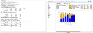

Hi, I get the error -40112 and I found that is an L3 RAM error:

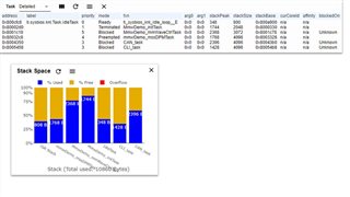

I also check the stack status of the tasks and everything seems ok
So, what could be the cause of this error?
