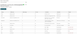

Don,
Our quality and reliability testing standards may be a useful reference here:
https://www.ti.com/qualificationsummary/qualsumm/home?actionId=2800
If you are rather asking about the number of times the magnetic field may be presented and removed from any particular device, I would expect this to not be an issue. The device has no upper limit to the applied magnetic field, and is monitoring the resulting voltage across the Hall element due to the Lorentz force. This essentially creates an unequal charge distribution through the conductive element when an applied current is driven in the sensor. The resulting potential is quite small and shouldn't cause any significant stress on the device.
