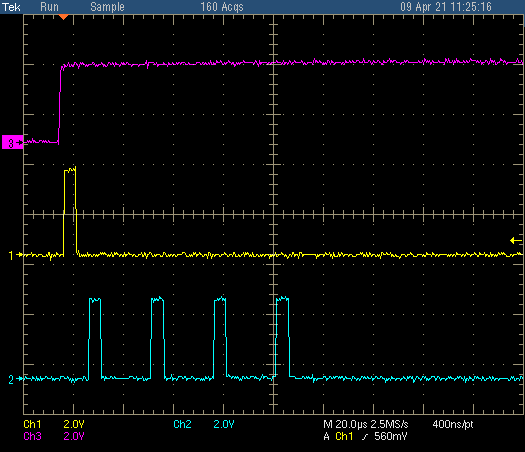

1. TDC1 is configured for one STOP pulse (and there's always only one), while TDC2 is configured for 5 STOP pulses. However, there are sometimes less than 5 STOP pulses that actually arrive. The maximum meaningful delay time is 10 us. The question is: if I read the registers after a 10 us delay, without waiting for all 5 pulses to arrive, will the readings be correct for those pulses that did arrive within 10 us?

    1. If you attempt to read the registers before you receive the last STOP in a 5 STOP configuration you will not obtain valid results from the registers. As you can see in the image below, I configured the TDC7201 to 5 STOPs but only sent 4 STOPs (blue channel). As you can see INTBx (purple channel) has not toggled again indicating that your measurement is complete and that the data is not available to read in the registers. I believe it would be better to go with an interrupt driven design waiting on INTBx to read the data as soon as its available.
