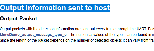

Hello
Your options would be
1) Modify the device code to send only the required TLV
or
2) Parse only the required TLV from the output stream.
Wonder if you have had a chance to look at the output data format explanation and Code structure deltails at
Tirex OOB demo
SDK OOB data format : (Typical Path) file:///C:/ti/mmwave_sdk_03_04_00_03/packages/ti/demo/xwr68xx/mmw/docs/doxygen/html/index.html
Hope this helps you select the right options to proceed.
Thank you
Vaibhav

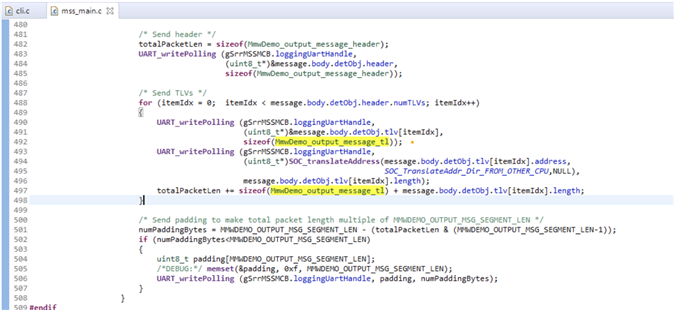

We want to modify the device code.
Where is relevant lines in the code? Is it in the DSS or in the MSS? Which parameter indicates the number of the TLV that is about to be send?
Is it enough just to ignore the other frames or they should be deleted?
Thanks for the help,
Ariel

We only found this lines that use the "MmwDemo_output_message" in the mss_main.c of the ppl counting lab.
Which lines indicates the number of the tlvs in the frame?
Hello
Can you please see what the that struct is defined as ?
Ideally start from magic word and go to the rest of TLV constriction.
