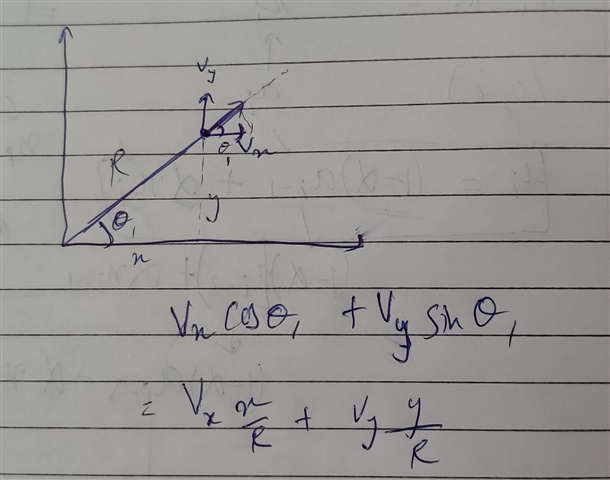

  • Hi Sreenath,
    For your second question, this calculation corresponds to the radial velocity. If you take the component of vx and vy along the line joining the radar and the object, you would get this.
    Aayush

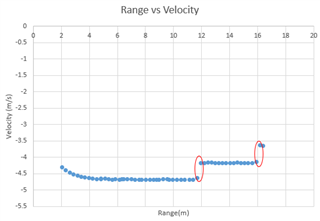

    2)Just a query regarding a trend we observed in doppler velocity of a particular tracked vehicle, we saw a sudden jump of velocity by about 0.5m/s between two points(marked in red) even when there was no significant acceleration/deceleration.
    What could be the reason?

  • Hi Sreenath,
    For 1, as far as I know, vx and vy from the tracker account for both radial and tangential velocity. Your equations don't take that into account. In my diagram, I had summed the component of vx and vy in the radial direction to get radial velocity. I could do the same in the tangential direction to get the tangential velocity.

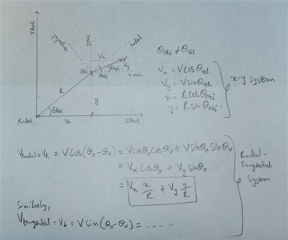

    I see where the confusion stems from. Neither of these views of Vx, Vy is correct. Perhaps my original, hastily drawn diagram didn't help with this either. Allow me to explain everything with a clean slate.
    Actual picture:
    1. V is the actual velocity of the object
    2. Vx, Vy reported by tracker are components of the object velocity along X and Y axis respectively. This is the same X, Y axis used for the pointcloud's distance data.
    3. Velocity V of object can also be represented by the components Vr, Vt (Vradial, Vtangential). Here, the radial direction is the direction of the line joining the radar to the object.
    4. The doppler velocity reported by the radar via pointcloud is only the radial component of the object velocity, Vr. This is because the doppler processing method cannot give any information about the tangential velocity, Vt.
    So, Vx and Vy reported by the tracker are not components of the radial velocity, rather they are components of the actual object velocity along the X and Y axes. Along with doppler velocity, the tracker also takes into account how the distance of a tracked object changes over time. This is how it can estimate Vx, Vy components of the object's velocity.
    So essentially, Vx, Vy are components of V in the X-Y coordinate system; Vr, Vt are components of V in the radial-tangential coordinate system.
    With this in mind, converting between these two is a simple coordinate transformation, which can be done with geometry.
    Here are the calculations for writing Vx, Vy, Vr, Vt in terms of V, angle of object (theta-o), angle of object velocity(theta-v):
    These calculations also show how to write Vr, Vt (Vt not shown) in terms of Vx, Vy, x, y.
    Aayush

  • Sreenath,
    I spoke with the developer of the lab. He says that while he has never seen behavior like this, one reason behind these sudden jumps in tracker velocity could be that the tracker is unable to track the targets velocity as it changes. There is code in the tracking algorithm (i.e. the EKF) that resets the tracker to the measurement if it deviates too much.
    I am not sure if this applies to your case, but I can't think of any other reasons for this behavior.

  • Hi Aayush,
    From CCS firmware of SRR , given by the macro SUBFRAME_SRR_CHIRPTYPE_0_VEL_RESOLUTION_M_P_S,
    Velocity Resolution(m/s) computes to approximately 0.52m/s.
    Can this be the reason we see a velocity jump?

  • Hi Sreenath,
    That is interesting. Could you compare this with the pointcloud doppler velocity? Since the doppler velocity is measured discretely (in doppler bin index), it will be in multiples of velocity resolution for sure.
    I am not sure if it can be expected of the tracker velocity to have more resolution than the input itself (the doppler velocity).
    Aayush

  • Hi Sreenath,
    This jump is seen due to the intrinsic nature of doppler processing. Doppler velocity is reported as the doppler bin index of the detected object. The overall maximum detectable velocity is distributed in "numDopplerBins" doppler bins, so the i'th doppler bin corresponds to the velocity i*(Vmax/numDopplerBins).
    While the velocity is reported as a real number, it is detected as an integer (the doppler index i). This is the unavoidable root cause of the discrete nature you see in the velocity reported by the point cloud.
    You cannot eliminate this jump, but theoretically, you can reduce the jump magnitude by increasing the number of doppler bins. In general, you would need more chirps to be able to get more doppler bins (spanning the same max velocity). This would cause the jump across each bin to be lower.
    These formulae are summarized in theory in this app note and this training series, and in practice in the source file: <SDK_INSTALL_LOC>/packages/ti/demo/utils/mmwdemo_rfparser.c. In the source file, the specific term you are looking to decrease is dopplerStep. The SRR lab doesn't use this file, or perhaps even the terminology used in the file, but the concepts would remain the same.
    I would say though that getting this to work might not be as easy as changing the hardcoded parameters to increase the number of chirps. It might or might not work. There would be the obvious memory, processing and timing considerations that come with increasing chirps, but there might be other unforeseen effects as well. I can't say for certain as the lab wasn't tested for this. The out of box demo provides much more flexibility to change chirp configs, but it doesn't have vmax extension or tracking.
