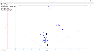

I'm testing Long Range People Detection Demo for detecting a people passing through a crosswalk with IWR6843ISK. (Toolbox 4.6.0 and SDK 3.5)
But Sensor is stopped when detection exceeds max num of point cloud or tracked object. (configuration by trackingCfg)
The figure below is the GUI screen just before stopping.
I want to know below.
1. Why the sensor stopped
2. How to keep the sensor working with many point clouds or tracked objects
Thanks.

  • Do you know exactly how many points or tracks it takes to make the sensor stop? Does this correspond with the values in tracking config?
  • No, I don't know how many points or tracks it takes to make the sensor stop. How calculate that values?
  • This would be reported in the TLV header output, and listed in the GUI. Also, it looks like you are using the traffic monitoring GUI? If you run this from the matlab source code, there is an option to record the data, which would allow you to parse the saved UART stream, or playback the session and pause when you get to where the sensor crashed.
    Please see the first section in tm_visualizer.m and set REAL_TIME_MODE and ENABLE_RECORD to 1, and this should save the data.
    Jackson
  • As a result of examining the long recorded by the MATLAB GUI program, the last packet before the sensor stops is as follows.
    02 01 04 03 06 05 08 07 01 00 05 03 43 68 0a 00 59 5a 62 9b c0 13 00 00 1f 02 00 00 00 00 00 00 00 00 00 00 00 00 00 00 00 00 00 00 00 00 00 00 04 00 f9 78 06 00 00 00 10 0d 00 00 f4 20 05 41 00 00 00 00 00 00 00 00 00 00 00 00 b7 f5 0c 41 56 05 00 3d 00 00 00 00 00 00 00 00 7a ca 14 41 56 05 00 3d 00 00 00 00 00 00 00 00 3d 9f 1c 41 00 00 00 00 00 00 00 00 00 00 00 00 6e b1 47 42 56 05 00 bd 00 00 00 00 00 00 00 00 9f a6 49 42 56 05 00 bd 00 00 00 00 00 00 00 00 d0 9b 4b 42 5f 15 80 bd 00 00 00 00 00 00 00 00 f4 20 05 41 56 05 00 3d 00 00 00 00 14 90 ff 3d b7 f5 0c 41 56 05 00 3d 00 00 00 00 14 90 ff 3d 3d 9f 1c 41 56 05 00 3d 00 00 00 00 14 90 ff 3d dc b4 18 42 86 a8 20 3e 00 00 00 00 14 90 ff 3d 0c aa 1a 42 86 a8 20 3e 00 00 00 00 14 90 ff 3d 3d 9f 1c 42 86 a8 20 3e 00 00 00 00 14 90 ff 3d 3d bc 45 42 5f 15 80 bd 00 00 00 00 14 90 ff 3d 6e b1 47 42 56 05 00 bd 00 00 00 00 14 90 ff 3d 9f a6 49 42 56 05 00 bd 00 00 00 00 14 90 ff 3d d0 9b 4b 42 5f 15 80 bd 00 00 00 00 14 90 ff 3d 00 91 4d 42 5f 15 80 bd 00 00 00 00 14 90 ff 3d 00 91 4d 42 6c d5 2c bf 00 00 00 00 14 90 ff 3d 0c aa 1a 42 f0 55 00 3e 00 00 00 00 14 90 7f 3e 3d 9f 1c 42 f0 55 00 3e 00 00 00 00 14 90 7f 3e 6e b1 47 42 56 05 00 bd 00 00 00 00 14 90 7f 3e 9f a6 49 42 56 05 00 bd 00 00 00 00 14 90 7f 3e d0 9b 4b 42 56 05 00 bd 00 00 00 00 14 90 7f 3e b7 f5 0c 41 a7 24 41 3e 00 00 00 00 8d b6 27 40 7a ca 14 41 a7 24 41 3e 00 00 00 00 8d b6 27 40 b7 f5 0c 41 a7 24 41 3e 00 00 00 00 0e b3 2f 40 7a ca 14 41 a7 24 41 3e 00 00 00 00 0e b3 2f 40 3d 9f 1c 41 a7 24 41 3e 00 00 00 00 0e b3 2f 40 b7 f5 0c 41 a7 24 41 3e 00 00 00 00 8e af 37 40 7a ca 14 41 a7 24 41 3e 00 00 00 00 8e af 37 40 3d 9f 1c 41 a7 24 41 3e 00 00 00 00 8e af 37 40 00 74 24 41 ad 8a 80 bf 00 00 00 00 cd b4 ab 40 00 74 24 41 29 f8 91 3e 00 00 00 00 cd b4 ab 40 00 74 24 41 2b cc 72 bf 00 00 00 00 0e b3 af 40 00 74 24 41 4e 5f 81 3e 00 00 00 00 0e b3 af 40 7a ca 14 41 21 aa b3 be 00 00 00 00 90 a8 c7 c0 3d 9f 1c 41 21 aa b3 be 00 00 00 00 90 a8 c7 c0 7a ca 14 41 21 aa b3 be 00 00 00 00 4f aa c3 c0 3d 9f 1c 41 21 aa b3 be 00 00 00 00 4f aa c3 c0 00 74 24 41 21 aa b3 be 00 00 00 00 4f aa c3 c0 3d 9f 1c 41 ca b9 a2 be 00 00 00 00 0f ac bf c0 00 74 24 41 ca b9 a2 be 00 00 00 00 0f ac bf c0 86 1d 34 41 ca b9 a2 be 00 00 00 00 4e b1 b3 c0 4a f2 3b 41 ca b9 a2 be 00 00 00 00 4e b1 b3 c0 86 1d 34 41 ca b9 a2 be 00 00 00 00 0e b3 af c0 4a f2 3b 41 ca b9 a2 be 00 00 00 00 0e b3 af c0 0d c7 43 41 ca b9 a2 be 00 00 00 00 0e b3 af c0 c3 48 2c 41 29 f8 91 be 00 00 00 00 cd b4 ab c0 86 1d 34 41 29 f8 91 be 00 00 00 00 cd b4 ab c0 4a f2 3b 41 29 f8 91 be 00 00 00 00 cd b4 ab c0 0d c7 43 41 29 f8 91 be 00 00 00 00 cd b4 ab c0 7a ca 14 41 4e 5f 81 be 00 00 00 00 8d b6 a7 c0 c3 48 2c 41 29 f8 91 be 00 00 00 00 8d b6 a7 c0 86 1d 34 41 29 f8 91 be 00 00 00 00 8d b6 a7 c0 4a f2 3b 41 29 f8 91 be 00 00 00 00 8d b6 a7 c0 0d c7 43 41 29 f8 91 be 00 00 00 00 8d b6 a7 c0 86 1d 34 41 29 f8 91 be 00 00 00 00 4d b8 a3 c0 4a f2 3b 41 29 f8 91 be 00 00 00 00 4d b8 a3 c0 c3 48 ac 41 29 f8 91 be 00 00 00 00 4d b8 a3 c0 25 33 b0 41 29 f8 91 be 00 00 00 00 4d b8 a3 c0 d0 9b 4b 41 4e 5f 81 be 00 00 00 00 8c bd 97 c0 93 70 53 41 4e 5f 81 be 00 00 00 00 8c bd 97 c0 56 45 5b 41 4e 5f 81 be 00 00 00 00 8c bd 97 c0 d0 9b 4b 41 4e 5f 81 be 00 00 00 00 4c bf 93 c0 93 70 53 41 4e 5f 81 be 00 00 00 00 4c bf 93 c0 56 45 5b 41 4e 5f 81 be 00 00 00 00 4c bf 93 c0 d0 9b 4b 41 4e 5f 81 be 00 00 00 00 0b c1 8f c0 93 70 53 41 4e 5f 81 be 00 00 00 00 0b c1 8f c0 56 45 5b 41 4e 5f 81 be 00 00 00 00 0b c1 8f c0 d0 9b 4b 41 4e 5f 81 be 00 00 00 00 cb c2 8b c0 93 70 53 41 4e 5f 81 be 00 00 00 00 cb c2 8b c0 56 45 5b 41 4e 5f 81 be 00 00 00 00 cb c2 8b c0 19 1a 63 41 79 d3 61 be 00 00 00 00 cb c2 8b c0 dc ee 6a 41 79 d3 61 be 00 00 00 00 cb c2 8b c0 9f c3 72 41 79 d3 61 be 00 00 00 00 cb c2 8b c0 b7 f5 0c 41 79 d3 61 be 00 00 00 00 8b c4 87 c0 7a ca 14 41 79 d3 61 be 00 00 00 00 8b c4 87 c0 3d 9f 1c 41 79 d3 61 be 00 00 00 00 8b c4 87 c0 d0 9b 4b 41 79 d3 61 be 00 00 00 00 8b c4 87 c0 93 70 53 41 79 d3 61 be 00 00 00 00 8b c4 87 c0 56 45 5b 41 79 d3 61 be 00 00 00 00 8b c4 87 c0 19 1a 63 41 79 d3 61 be 00 00 00 00 8b c4 87 c0 dc ee 6a 41 79 d3 61 be 00 00 00 00 8b c4 87 c0 9f c3 72 41 79 d3 61 be 00 00 00 00 8b c4 87 c0 19 1a 63 41 79 d3 61 be 00 00 00 00 4a c6 83 c0 dc ee 6a 41 79 d3 61 be 00 00 00 00 4a c6 83 c0 9f c3 72 41 79 d3 61 be 00 00 00 00 4a c6 83 c0 19 1a 63 41 79 d3 61 be 00 00 00 00 14 90 7f c0 dc ee 6a 41 79 d3 61 be 00 00 00 00 14 90 7f c0 9f c3 72 41 79 d3 61 be 00 00 00 00 14 90 7f c0 dc ee 6a 41 79 d3 61 be 00 00 00 00 93 93 77 c0 93 36 81 41 79 d3 61 be 00 00 00 00 93 93 77 c0 f4 20 85 41 79 d3 61 be 00 00 00 00 93 93 77 c0 62 98 7a 41 a7 24 41 be 00 00 00 00 13 97 6f c0 93 36 81 41 a7 24 41 be 00 00 00 00 13 97 6f c0 f4 20 85 41 a7 24 41 be 00 00 00 00 13 97 6f c0 62 98 7a 41 a7 24 41 be 00 00 00 00 92 9a 67 c0 93 36 81 41 a7 24 41 be 00 00 00 00 92 9a 67 c0 f4 20 85 41 a7 24 41 be 00 00 00 00 92 9a 67 c0 c3 2b 03 42 0e 50 4d 3f 00 00 00 00 92 9a 67 c0 c3 48 2c 41 a7 24 41 be 00 00 00 00 12 9e 5f c0 86 1d 34 41 a7 24 41 be 00 00 00 00 12 9e 5f c0 c3 2b 03 42 0e 50 4d 3f 00 00 00 00 12 9e 5f c0 00 74 24 41 a7 24 41 be 00 00 00 00 91 a1 57 c0 c3 48 2c 41 a7 24 41 be 00 00 00 00 91 a1 57 c0 86 1d 34 41 a7 24 41 be 00 00 00 00 91 a1 57 c0 00 74 24 41 a7 24 41 be 00 00 00 00 10 a5 4f c0 c3 48 2c 41 a7 24 41 be 00 00 00 00 10 a5 4f c0 00 ae f6 41 6c d5 2c 3f 00 00 00 00 10 a5 4f c0 62 98 fa 41 6c d5 2c 3f 00 00 00 00 10 a5 4f c0 dc b4 98 41 f0 55 00 be 00 00 00 00 90 a8 47 c0 3d 9f 9c 41 f0 55 00 be 00 00 00 00 90 a8 47 c0 3d d9 ee 41 6c d5 2c 3f 00 00 00 00 90 a8 47 c0 9f c3 f2 41 6c d5 2c 3f 00 00 00 00 90 a8 47 c0 00 ae f6 41 6c d5 2c 3f 00 00 00 00 90 a8 47 c0 62 98 fa 41 6c d5 2c 3f 00 00 00 00 90 a8 47 c0 dc b4 98 41 f0 55 00 be 00 00 00 00 0f ac 3f c0 3d 9f 9c 41 f0 55 00 be 00 00 00 00 0f ac 3f c0 9f c3 f2 41 6c d5 2c 3f 00 00 00 00 0f ac 3f c0 00 ae f6 41 6c d5 2c 3f 00 00 00 00 0f ac 3f c0 62 98 fa 41 6c d5 2c 3f 00 00 00 00 0f ac 3f c0 62 5e a8 41 f0 55 00 be 00 00 00 00 0e b3 2f c0 62 98 7a 41 5f 15 80 bd 00 00 00 00 12 9e df bf 93 36 81 41 5f 15 80 bd 00 00 00 00 12 9e df bf 93 36 81 41 5f 15 80 bd 00 00 00 00 10 a5 cf bf dc b4 98 41 5f 15 80 bd 00 00 00 00 10 a5 cf bf 7a ca 94 41 5f 15 80 bd 00 00 00 00 0f ac bf bf dc b4 98 41 5f 15 80 bd 00 00 00 00 0f ac bf bf 3d 9f 9c 41 5f 15 80 bd 00 00 00 00 0f ac bf bf 86 1d 34 41 5f 15 80 bd 00 00 00 00 0e b3 af bf 7a ca 94 41 5f 15 80 bd 00 00 00 00 0e b3 af bf dc b4 98 41 5f 15 80 bd 00 00 00 00 0e b3 af bf 3d 9f 9c 41 5f 15 80 bd 00 00 00 00 0e b3 af bf 9f 89 a0 41 5f 15 80 bd 00 00 00 00 0e b3 af bf 00 74 a4 41 5f 15 80 bd 00 00 00 00 0e b3 af bf 62 5e a8 41 5f 15 80 bd 00 00 00 00 0e b3 af bf c3 48 ac 41 5f 15 80 bd 00 00 00 00 0e b3 af bf 7a ca 94 41 5f 15 80 bd 00 00 00 00 0c ba 9f bf dc b4 98 41 5f 15 80 bd 00 00 00 00 0c ba 9f bf 3d 9f 9c 41 5f 15 80 bd 00 00 00 00 0c ba 9f bf 9f 89 a0 41 5f 15 80 bd 00 00 00 00 0c ba 9f bf 00 74 a4 41 5f 15 80 bd 00 00 00 00 0c ba 9f bf 62 5e a8 41 5f 15 80 bd 00 00 00 00 0c ba 9f bf c3 48 ac 41 5f 15 80 bd 00 00 00 00 0c ba 9f bf 25 33 b0 41 5f 15 80 bd 00 00 00 00 0c ba 9f bf ab dc bf 41 5f 15 80 bd 00 00 00 00 0c ba 9f bf 0d c7 c3 41 5f 15 80 bd 00 00 00 00 0c ba 9f bf dc b4 98 41 5f 15 80 bd 00 00 00 00 0b c1 8f bf 3d 9f 9c 41 5f 15 80 bd 00 00 00 00 0b c1 8f bf 00 74 a4 41 5f 15 80 bd 00 00 00 00 0b c1 8f bf 62 5e a8 41 5f 15 80 bd 00 00 00 00 0b c1 8f bf c3 48 ac 41 5f 15 80 bd 00 00 00 00 0b c1 8f bf 25 33 b0 41 5f 15 80 bd 00 00 00 00 0b c1 8f bf 86 1d b4 41 5f 15 80 bd 00 00 00 00 0b c1 8f bf e8 07 b8 41 5f 15 80 bd 00 00 00 00 0b c1 8f bf 56 45 db 41 56 05 00 bd 00 00 00 00 0b c1 8f bf 19 1a 63 41 56 05 00 bd 00 00 00 00 14 90 7f bf dc ee 6a 41 56 05 00 bd 00 00 00 00 14 90 7f bf 00 74 a4 41 56 05 00 bd 00 00 00 00 14 90 7f bf 62 5e a8 41 56 05 00 bd 00 00 00 00 14 90 7f bf c3 48 ac 41 56 05 00 bd 00 00 00 00 14 90 7f bf 25 33 b0 41 56 05 00 bd 00 00 00 00 14 90 7f bf 86 1d b4 41 56 05 00 bd 00 00 00 00 14 90 7f bf e8 07 b8 41 56 05 00 bd 00 00 00 00 14 90 7f bf 0d c7 c3 41 5f 15 80 bd 00 00 00 00 14 90 7f bf 56 45 5b 41 56 05 00 bd 00 00 00 00 12 9e 5f bf 19 1a 63 41 56 05 00 bd 00 00 00 00 12 9e 5f bf dc ee 6a 41 56 05 00 bd 00 00 00 00 12 9e 5f bf 62 98 7a 41 56 05 00 bd 00 00 00 00 12 9e 5f bf 93 36 81 41 56 05 00 bd 00 00 00 00 12 9e 5f bf 86 1d b4 41 56 05 00 bd 00 00 00 00 12 9e 5f bf e8 07 b8 41 56 05 00 bd 00 00 00 00 12 9e 5f bf 3d 9f 1c 42 5f 15 80 bd 00 00 00 00 12 9e 5f bf 25 33 30 42 56 05 00 bd 00 00 00 00 12 9e 5f bf 56 45 5b 41 56 05 00 bd 00 00 00 00 0f ac 3f bf 19 1a 63 41 56 05 00 bd 00 00 00 00 0f ac 3f bf dc ee 6a 41 56 05 00 bd 00 00 00 00 0f ac 3f bf 62 98 7a 41 56 05 00 bd 00 00 00 00 0f ac 3f bf 93 36 81 41 56 05 00 bd 00 00 00 00 0f ac 3f bf b7 f5 8c 41 56 05 00 bd 00 00 00 00 0f ac 3f bf 19 1a 63 41 56 05 00 bd 00 00 00 00 0c ba 1f bf 4a f2 3b 41 56 05 00 bd 00 00 00 00 14 90 ff be f4 20 05 42 c5 ca f9 3e 00 00 00 00 0f ac bf be 25 16 07 42 c5 ca f9 3e 00 00 00 00 0f ac bf be 56 0b 09 42 92 0a 06 3f 00 00 00 00 0f ac bf be f4 20 05 41 00 00 00 00 00 00 00 00 14 90 7f be b7 f5 0c 41 00 00 00 00 00 00 00 00 14 90 7f be 7a ca 14 41 00 00 00 00 00 00 00 00 14 90 7f be 3d 9f 1c 41 00 00 00 00 00 00 00 00 14 90 7f be 7a ca 94 41 56 05 00 3d 00 00 00 00 14 90 7f be c4 82 fe 41 a7 cf c4 3e 00 00 00 00 14 90 7f be 93 36 01 42 21 aa b3 3e 00 00 00 00 14 90 7f be c3 2b 03 42 a7 cf c4 3e 00 00 00 00 14 90 7f be f4 20 05 42 94 d7 e7 3e 00 00 00 00 14 90 7f be 25 16 07 42 92 0a 06 3f 00 00 00 00 14 90 7f be 56 0b 09 42 92 0a 06 3f 00 00 00 00 14 90 7f be 86 00 0b 42 92 0a 06 3f 00 00 00 00 14 90 7f be f4 20 05 41 56 05 00 3d 00 00 00 00 14 90 ff bd b7 f5 0c 41 56 05 00 3d 00 00 00 00 14 90 ff bd 7a ca 14 41 00 00 00 00 00 00 00 00 14 90 ff bd 3d 9f 1c 41 00 00 00 00 00 00 00 00 14 90 ff bd c4 82 fe 41 a7 cf c4 3e 00 00 00 00 14 90 ff bd 93 36 01 42 21 aa b3 3e 00 00 00 00 14 90 ff bd c3 2b 03 42 21 aa b3 3e 00 00 00 00 14 90 ff bd f4 20 05 42 a7 cf c4 3e 00 00 00 00 14 90 ff bd 25 16 07 42 92 0a 06 3f 00 00 00 00 14 90 ff bd 56 0b 09 42 18 61 0f 3f 00 00 00 00 14 90 ff bd 86 1d 34 42 4e 5f 81 3e 00 00 00 00 14 90 ff bd 09 00 00 00 44 03 00 00 6b 01 90 02 f8 01 94 02 1f 02 98 02 ff 01 91 02 91 00 a4 02 b2 00 ac 02 91 00 ae 02 02 01 e6 02 85 01 f0 02 a2 01 e7 02 9f 00 af 02 ec 00 a9 02 ce 00 ae 02 6c 00 ae 02 d6 00 ab 02 fa 00 aa 02 dd 00 a5 02 6e 00 a7 02 6e 00 a7 02 b7 00 a4 02 a0 00 a4 02 b0 00 a5 02 ce 00 a3 02 a3 00 a5 02 09 01 9c 02 51 01 97 02 13 01 a9 02 66 01 a5 02 6f 01 a1 02 f0 00 9e 02 46 01 9d 02 57 01 9c 02 c6 00 79 02 c6 00 79 02 af 00 88 02 af 00 88 02 09 01 7f 02 3d 01 82 02 0e 01 87 02 5e 01 81 02 58 01 7d 02 58 01 79 02 5f 01 78 02 41 01 90 02 33 01 8c 02 8f 01 93 02 90 01 91 02 32 01 93 02 7d 01 94 02 c0 01 a5 02 bc 01 a4 02 5e 01 a4 02 3c 01 88 02 73 01 8f 02 af 01 a4 02 9a 01 b2 02 3f 01 ad 02 48 01 a7 02 3a 01 b0 02 83 00 ac 02 99 00 aa 02 1b 01 b3 02 29 01 b2 02 e1 00 b5 02 4f 01 a8 02 59 01 aa 02 05 01 af 02 2f 01 9f 02 44 01 9e 02 18 01 a7 02 e6 00 c4 02 1c 01 ab 02 1d 01 a8 02 18 01 a5 02 0e 01 9e 02 cf 00 9e 02 ff 00 7c 02 79 01 78 02 8f 01 7c 02 ab 00 e9 02 e9 00 c3 02 ec 00 b2 02 1b 01 ad 02 4d 01 a4 02 23 01 a1 02 22 01 af 02 5c 01 a3 02 31 01 a0 02 b4 00 d0 02 f2 00 be 02 c7 00 b3 02 bb 00 cf 02 da 00 b0 02 d0 00 a9 02 c3 00 bb 02 02 01 af 02 f0 00 a7 02 9a 00 c5 02 d5 00 b9 02 c0 00 b5 02 81 00 a9 02 50 01 98 02 16 01 a7 02 71 00 a8 02 8a 01 7b 02 7b 01 7e 02 20 01 96 02 6f 01 75 02 3b 01 74 02 71 00 a2 02 75 00 9d 02 77 00 b0 02 8b 00 ab 02 77 00 a7 02 8b 00 ab 02 ab 00 ae 02 8d 00 b1 02 96 00 a4 02 ae 00 9e 02 9d 00 96 02 b7 00 97 02 88 00 9a 02 7e 00 ae 02 6d 00 1a 03 8e 00 02 03 7c 00 2d 03 7c 00 08 03 7b 00 1a 03 c4 00 0f 03 b4 00 0e 03 ed 00 bf 02 a0 00 1c 03 e7 00 1a 03 e0 00 11 03 69 00 07 03 bc 00 fc 02 d0 00 f5 02 93 00 f0 02 90 00 2b 03 e5 00 1b 03 da 00 16 03 99 00 0a 03 ff 00 fd 02 0c 01 fd 02 ca 00 fc 02 8b 00 ee 02 84 00 ed 02 79 00 ea 02 a0 00 36 03 8f 00 39 03 b9 00 2d 03 da 00 18 03 9a 00 1e 03 a5 00 19 03 db 00 04 03 b1 00 00 03 77 00 d9 02 9a 00 4f 03 6a 00 5c 03 8e 00 1c 03 b4 00 ff 02 74 00 f0 02 d0 00 db 02 0a 01 c8 02 da 00 ce 02 71 00 e9 02 88 00 56 03 d1 00 40 03 a5 00 48 03 a1 00 32 03 9e 00 30 03 8e 00 17 03 66 00 1d 03 64 00 db 02 69 00 b6 02 7a 00 44 03 a0 00 52 03 76 00 57 03 85 00 32 03 86 00 2e 03 69 00 4b 03 71 00 31 03 93 00 17 03 7c 00 ba 02 b4 00 b8 02 9e 00 b7 02 6d 01 9f 02 f5 01 a3 02 16 02 a6 02 e0 01 a7 02 74 00 0e 03 6d 00 d0 02 a1 00 c7 02 a7 00 bf 02 c0 00 b7 02 f4 00 b2 02 d2 00 bf 02 71 00 d3 02 5d 01 e5 02 e2 01 ec 02 13 02 e1 02 f6 01 d0 02 76 00 cc 02 a3 00 c8 02 9b 00 bd 02 81 00 b5 02 b3 00 b2 02 96 00 c0 02 70 00 d3 02 07 00 00 00 30 02 00 00 02 00 00 00 a8 6c 3a 3f 77 bd 98 40 6d f5 e8 2f 00 00 00 00 00 00 00 00 00 00 00 00 00 00 00 00 00 00 00 00 00 00 00 00 37 cd 08 3e f6 0b 1d bd a4 04 f7 2d 84 d3 eb bc f6 0b 1d bd 88 ac 1d 40 4d 5a 46 2d 4c c2 14 bf a4 04 f7 2d 48 5a 46 2d ff 6d 81 41 73 c5 8d af 84 d3 eb bc 4c c2 14 bf 74 c5 8d af c8 f7 59 40 00 00 80 40 fc ff 7f 3f 03 00 00 00 11 41 0c c0 86 53 f4 40 f5 78 b2 3d 2b a7 63 40 dd 73 79 c0 4a f9 87 be dd 40 3f bf f4 45 78 40 db 82 51 3c 7c 3c e0 3d ab cd 1c bd ab 06 d8 34 1d d0 c4 bb ab cd 1c bd 2c 83 28 41 0b ac f0 b6 29 c9 7d bd 48 06 d8 34 31 ac f0 b6 65 79 33 41 db c4 f3 35 1d d0 c4 bb 29 c9 7d bd f3 c4 f3 35 ff 27 8c 3c 00 00 80 40 6d 56 6d 3f 04 00 00 00 bf 91 84 c0 63 2a 62 41 4f a5 83 3e 35 7d 09 bf 0e 8f ea 3f ff 87 08 3d 00 00 00 00 00 00 00 00 00 00 00 00 e3 e4 e5 3d c6 69 98 b2 00 00 00 00 4d 03 9f bb c6 69 98 b2 4b 10 b5 41 00 00 00 00 5a 9f 03 b4 00 00 00 00 00 00 00 00 4b 10 b5 41 00 00 00 00 4d 03 9f bb 5a 9f 03 b4 00 00 00 00 23 2e a5 3f 00 00 80 40 66 66 66 3f 05 00 00 00 d3 77 17 bf eb 00 93 41 fa af a0 3e 86 a1 f9 bd b7 ce d6 bf 7c 1a cf bd 96 15 c5 bc 4f a2 b3 3d 66 80 ed bb d0 70 e3 3d 46 77 b1 b1 00 00 00 00 7a a4 ad bb 46 77 b1 b1 2f 18 1d 42 00 00 00 00 3c f5 be b2 00 00 00 00 00 00 00 00 2f 18 1d 42 00 00 00 00 7a a4 ad bb 3c f5 be b2 00 00 00 00 66 4b a7 3f 00 00 80 40 ae 47 01 3f 06 00 00 00 cb 7d 4c c0 5f 2a 52 41 a6 a2 71 3e 8b 58 84 3f a5 04 88 c0 a1 62 9c bd 00 00 00 00 00 00 00 00 00 00 00 00 00 00 00 00 00 00 00 00 00 00 00 00 00 00 00 00 00 00 00 00 00 00 00 00 00 00 00 00 00 00 00 00 00 00 00 00 00 00 00 00 00 00 00 00 00 00 00 00 00 00 00 00 00 00 00 00 00 00 00 00 00 00 00 00 00 00 80 40 66 66 e6 3e 08 00 00 00 d1 00 00 00 03 03 03 03 ff ff ff 03 03 03 fe fe fe ff ff ff ff ff fe fe fe ff ff ff ff ff ff ff ff ff ff ff fe ff fe ff 03 03 03 03 03 03 03 ff ff ff ff ff 03 ff ff ff 03 03 ff ff ff ff ff fe fe ff ff 06 ff 06 06 06 06 06 06 06 06 06 ff ff 03 03 03 06 06 06 06 ff ff 06 ff ff 06 ff ff ff ff ff ff ff ff 05 05 05 fe 03 ff fe 03 03 ff 03 03 fe fe 05 05 fe fe fe fe 05 05 fe fe fe 05 05 05 05 05 05 05 05 ff 05 05 05 05 05 05 ff 05 05 05 05 05 05 ff ff ff ff 05 05 05 05 ff ff ff ff ff ff ff 05 05 ff ff ff ff ff ff ff ff 05 05 ff ff ff ff ff ff ff 05 05 05 ff ff fe fe fe 03 03 03 03 05 fe fe fe fe fe fe fe 03 03 03 03 fe fe fe fe fe fe fe df 01 00 00 df 01 00 00 df 01 00 00 df 01 00 00 05 00 01 00 80 57 00
    Point Cloud TLV length = 0xd10, calculated based on this, the number of point cloud is 209.
    and target list TLV length = 0x230, the number of target is 5.
    I guess, sensor would have stopped due to memory overflow in this next frame process.
    1) What memory is causing the sensor to stop? (MSS data RAM(192K), Handshake RAM(32K) or L3 RAM?)
    2) If can not reduce the number of point clouds(due to sensing performance), is there another solution?
    Thanks.
