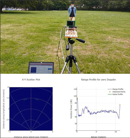

we tried to use the AWR1642 EVM and mmWave demo visualizer to detect a human moving towards and away from the radar along the
DOA = 0 degree direction.
We got multiple detection points which may be considered as two clusters:
The two clusters are distributed around the left side and the right side of the moving person;
it seems that the cluster distribution are symmetric about the person.
The farther the distance between the radar and the moving person is, the larger the separation between the two clusters is.
The separation between the two clusters is larger than 3 meters when the distance between the radar and the person is larger
than 7.5 meter according the "X-Y Scatter Plot" shown in mmWave demo visualizer.

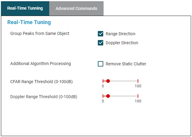

2. Are there any parameters we could adjust to get correct detection point?

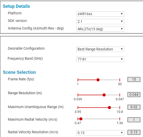

our radar settings:

    This could be multi-path reflections. If you repeat the experiment in an open environment do you still see the 2 clusters?
    Thank you
    Cesar
    actually we conducted this experiment in an open environment as you could see in the image below.
    Could this be multi-path reflections?
    Thanks for your help.
    Edward Lee
  • No,
    This does not seem to be multi-path reflections.
    We would need more information to debug.
    Are there any tests where you don't get this behavior?
    Was this behavior always the same or did it start at some point? Maybe it is an EVM issue.
    Thank you
    Cesar

  • Sorry to hear that.
    I see on the picture you have attached that there are some othe boards attached to the sensor board.
    Would it be possible to test the demo only with the BOOST board?
    If there still is a problem, I think that there is a problem with the board.
