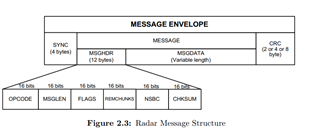

  • Yes, i have changed the host processor, and want to send the data through a mezzanine connector rather than through ethernet. In the file mmw_example.c and mmwavelink.h has porting instructions to be able to run this program through a different host processor, OS and processor indepent, correct?
    "TI mmwave front end is a closed subsystem whose internal blocks are configurable using messages
    coming over mailbox.\n TI mmWaveLink provides APIs generates these message and sends it to mmwave
    front end over mailbox. It also includes acknowledement and CRC for each message to provide a
    reliable communication"
    In the Interface Control Document, shows a message envelope:
    is this the data format that the awr2243 chip is expecting to receive? or is this the microcontroller on the tda board is expecting to see?
    Thank you
  • Interface Control Document is explains message format what AWR2243 device expects over SPI/I2C from external processor. above image shows message format for AWR2243 device only and this message byte packaging is taken care by mmwavelink library.
    AWR2243 has only two communication interface SPI or I2C, so external Host processor which are planning to switch needs to have either of these interface available. In case of cascade, TDA2x uses SPI interface to send/receive command/response from AWR2243 device.
    If you follow mmwavelink source, document and interface control document together you would find the porting instructions for mmwavelink to your host processor.
