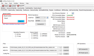

I want to flash bin and config via serial communication (ex.TeraTerm) in USB port without uniflash.
Could you show me some documentation or commands?

mmWave Studio will use the mmWave Link API to communicate with the sensor through SPI.
These API commands are documented in the Radar Interface Control Document provided with the DFP release
C:\ti\mmwave_dfp_02_02_02_01\docs\mmWave-Radar-Interface-Control.pdf
So if you are able to observe the SPI line you will see these commands.
