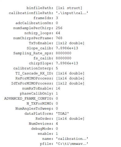

    Here is calibrationObj info read from matlab workspace
    To remove the impact of calibration, we set calibrationObj.adcCalibrationOn=0. Basically, the process script generated the same plots with above mentioned three dataset.  (if calibrationObj.adcCalibrationOn=1, the conclusion is the same.)
