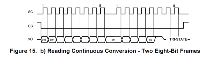

Dear Sirs,
My customer wants to read 2 bytes data with SPI, but found he cannot get data within the same SS period.
The source code also attached.
Please help to review it if there is any problem.

unsigned short LM74_ReadRegister(void)
    unsigned char HByte;
    unsigned char LByte;
    unsigned short TWord;
    SENSOR_CS_LOW;
    //wait for completion of send
    UCB0TXBUF = 0x00;                   // Transmit the byte
    while (!(IFG2 & UCB0TXIFG));        // USCI_B0 TX buffer ready?
    IFG2 &= ~(UCB0TXIFG);               //clear the interrupt flag
    while (!(IFG2 & UCB0RXIFG));        // USCI_B0 RX Received?
    IFG2 &= ~(UCB0RXIFG);               //clear the interrupt flag
    HByte = UCB0RXBUF;
    LByte = UCB0RXBUF;
    SENSOR_CS_HI;
    TWord = ((HByte<<8)| LByte)>>3;
 //   TWord = TWord>>3;
    return (TWord*0.0625);
