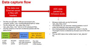

        I think the size would be 'sequence number(2bytes)+data length(2bytes)+byte count(6bytes)+raw mode data(48~1462bytes)'.
        Is this calculation right?

    Please refer to the screenshot below for determining the size of the UDP packet.
