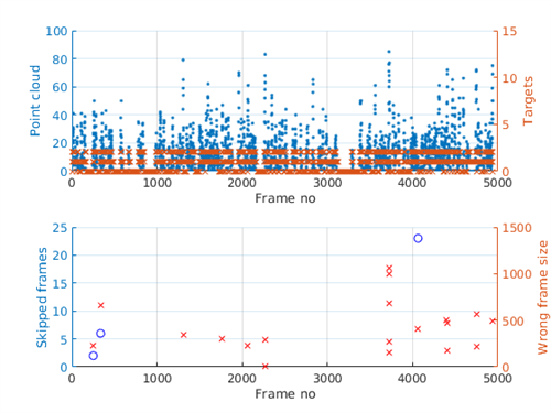

    The plot below shows some statistics I collected during one run that failed after approx 5000 frames. This is a unusually long one as most stop earlier than that. The red crosses on top show the number of targets and the blue dots show the number of pointcloud points. The bottom plot show random problems with the frames, such as skipped frames (a certain number of frames that are never received) and frames where the totalPacketLength does not match the number of bytes between magicWord starts.
    Looking at that, I did not think that changing tracking parameters would solve anything as I am only getting at most 2 targets. So I focused on things that would reduce the number of points instead.
    I changed this setting to
    aoaFovCfg -1 -5 5 -5 5
    and that allowed the board to run for several hours with a very small amount of frame issues. It seems that by reducing the FOV volume, I get a smaller number of points and the suspected memory overflows do not take place.
    However, my detection area is now very small so this does not solve my problem as I cannot track vehicles. I would like to find away to reduce the number of points and still have the larger area. I am not a radar expert, but I suspect the cfar threshold could be helpfull? Do you have any ideas or any documentation that would help me achieve what I need?

  • Thank you for diving into this. Since you are tracking cars, is 3D really required? I would suggest testing with MIMO_2d.cfg. Or as you mention, limit AoA to your specific field of interest (limiting as much as possible in 3D).
    If not possible, then you could adjust the range or velocity resolution of the device. Range resolution is done by changing the Num of ADC samples or chirp bandwidth. Velocity resolution is done by changing the number of chirps per frame (hence the 2D suggestion). Or you could reduce the num loops parameter in frameCfg. CFAR would certainly adjust the total number of points. There are many options here. I would highly recommend being familiar with Table 1 of the mmWave SDK User's Guide. All SDK chirp parameters are listed in this table.

    We managed to get it working with the original volume specified in aoaFovCfg. What I did was to change the cfar range averaging window from 8 to 10. That was enough to reduce the size of the point cloud so that no memory issues occured.
    Thanks for your help.
