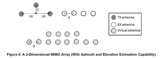

the virtual antennas form:
in order to extract the angle:
for one TX antenna only, we have a linear Rx array and the azimuth angle estimation is simple:
we should only choose the target range gate and perform an FFT over all Rx antennas.
for the MIMO case we have this non conventional array:
and my question is how to estimate azimuth and elevation?
I will be glad if anyone can help me with the correct procedure to extract azimuth and elevation.

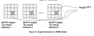

    I have downloaded the document and the only reference to angle estimation is:
    I still dont sure how to extract azimuth and eleveation from this virtual array.
    any help is much appreciated.

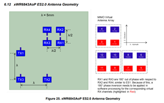

  • It may be easier to review the documentation provided in an earlier version of the mmWave SDK
    Please see sections after Antenna Configurations
    Millimeter Wave (mmw) Demo for XWR14XX
    Do you have a DCA1000 board to collect the ADC raw data?
    mmWave Studio includes integrated matlab processing functions that will perform angle estimation
    If you would like to develop your own matlab processing scripts there will be more effort involved.
