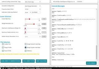

    2. The radar parameters are configured successfully, see the figure below:
  • Hello:
    We are going circles here. I need you to answer the following questions for my support to continue. Some of these may have been answered above, but I need a clear response.
    1. Are you able to successfully run the OOB demo @ 921600 baud (default baud)?
    2. Assuming (1) has been successful. Can you program your device with that .cfg file such that data is coming over the data COM port. If (1) is indeed working then you should be able to see that same data that is driving the visualizer over a PuTTY or Teraterm. Google these programs if you don't have them on your machine.
    3. Assuming (2) is functional. Implement your python script to parse the data coming through the COM port.
    4. If  (3) is functional. Then try changing configuration and see if it breaks.
