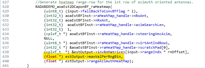

    1) In the call of RADARDEMO_aoaEst2DCaponBF_raHeatmap we pass the the first range bin address of max. value array (see yellow highlight on the screenshot below):

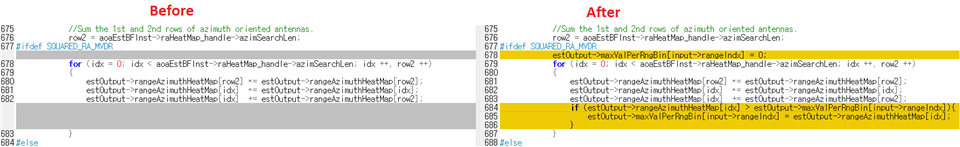

    2) Further, after calling RADARDEMO_aoaEst2DCaponBF_raHeatmap two times (for two antenna rows), we square and sum up the calculation results for two antenna rows. Therefore, the max. value has to be re-calculated anyway (even if we pass the correct range bin address). However, the re-calculation is not done.
    I believe, following change in RADARDEMO_aoaEst2DCaponBF.c file would fix the issue (provided that the first range bin is ignored).
    I have confirmed that in the original code the array azMaxPerRangeBin used for thresholding in RADARDEMO_detectionCFAR_raCAAll function contains random float values. Whereas after the change which I suggested above, the non-ignored range bin elements of azMaxPerRangeBin contain the expected data: maximum values of range bins in the calculated heatmap.
    I would appreciate if you confirm whether the above is correct or not.
