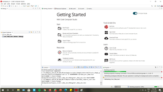

Hi Team,
I have downloaded mmwave_automotive_toolbox_3_3_0__win and mmwave_sdk_03_05_00_04. I have imported Medium Wave Radar(2 project) to CCS from automotive toolbox. My CCS version is CCS10.3.0.00007
First I did rebuild of DSS project and it was successful.
Then I started to build MSS project. For that ,the build is not getting complete.The build is at 39% in CCS.
If I force-stop the build, I am getting the error like,
Error: Program "C:/ti/ccs/utils/bin/gmake" is not found in PATH
I need to build this MSS project and I need to test mrr_mediumrangeradar in automative toolbox.
I also tried with the solution provided earlier for similar problem but still it doesn't give out any result
Following are the attachments of the problem faced and solution tried for the same that is already provided.
