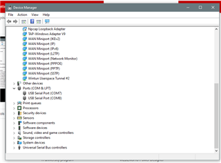

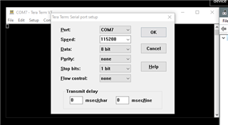

I'm trying to set up the MMWCAS-DSP-EVM and the MMVCAS-RF-EVM according to the mmWave Studio user guide. However, I don't see any output in the serial console from both serial ports.
The power LEDs, and the USB serial LEDs are lit but there's just no output in the serial console or any other sign of board activity. I've tried pressing SW1 as documented in the user guide but nothing changes. I've also tried rewriting the TDA firmware on the SD card but that does not work as well.
Could it be that I have a damaged board? What else can I do to troubleshoot?
