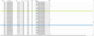

I2C protocol analyzer screenshot for your reference.

    Temperature drop issue #1:
    The results are fine till the value of temp MSB 0x01 [timestamp 101.17.898]
    Still, I am seeing a sudden drop in temperature. Any comments?

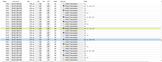

    Measurement Configuration issue #2:
     Do you know why the value of the reg Measurement Configuration reading 0xF6?

    Please see this forum post: https://e2e.ti.com/support/sensors/f/sensors-forum/879641/hdc2080-taking-more-time-for-data-ready . Please then scroll down to where I responded and you will see a firmware workaround by which you can clear the 0xF6 in register 0x0F issue.

    I am still not clear why the temperature dropped down rapidly before even the config register gets corrupted(0xFE).
    Did you review the issue#1 snapshot, temperature seems to be invalid even though the master sends 0x01 to 0x0F?

    To me it looks like you continue to send 0x01 to 0x0F and then increment pointer and read register value - this is not the way
    you should send 0x01 to 0x0F, then set pointer to 0x00, then read out all four bytes (0x00 through 0x03) at one time - this is the correct way to use the part.

    OK - I see now what you mean - actually you wait 2.413mSec between starting conversion and setting pointer to 0x00.
    I previously misread the column for duration as time between commands, but the column prior to that has the time stamps, so for example sending address byte, and writing 0x0F with 0x01 at ~100kHz does in fact take about 300uSec (I measured 293uSec, your time was about about 337uSec, so you must be running a little slower than 100kHz on the I2C) -
    Anyway, that should be fine, but it sure looks like to me that you are clocking out two bytes, which in this case would first be registers 0x00 and 0x01, where you get 0x2A76 (which is 0x762A or 30250d or 35.54°C, then you set pointer to 0x01 and clock out two bytes, so you get 0x01 again and 0x02, which is 0x76E7 and the MSByte of temp and LSB of %RH value, which is meaningless to you. Then you repeat that with 0x02 and 0x03. Plus in between you are sending 0x0F blank? I think you should just read out all the bytes at once, because the way you are doing it, it wastes clock cycles.
    Then to your point, the next time around (~20 seconds later) when you get back to reading the 0x00 and 0x01 registers correctly, the temp was 0x7D66 ==> 0x667D, which equates to 25.436°C. I am not sure what your ambient conditions were - was this in a chamber or controlled environment - or just on desktop?

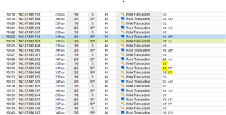

  • Hi Josh,
    This issue is getting reproduced in my setup again.
    Do you have any recommendations?
    Is there any initialization I need to do for this part?

    Issue persists with 4 bytes read
  • Ganesh -
    the only thing i can see in your transactions that looks odd at this point is the 0x00 write to 0x0F in between your transactions.
    I do see that the temp difference is about 10 degrees different, as you say - since its on desktop, you may want to put this in a chamber or check if you laptop fan is blowing on it or a cup of tea or coffee was placed nearby during the testing (this is common on my desk) - probably best to isolate the unit and eliminate outside influences.
  • Josh,
    That is not written to 0x0F, I am reading to confirm that this register is not corrupted before doing the trigger operation.
  • ok - thanks - I see that now - you should get a logic analyzer :) and try to find a chamber.
