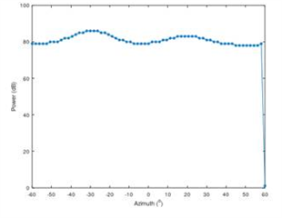

    The figures show my measurement results (angle spectrum at the dedicated range, the x-axis is the angle (deg) and the y-axis is the power (dB)):
    Before the verification, I temporarily skipped the mechanism of "static removal" to see the CR.
    If I remove one CR, the spectrum shows below (the peak is obvious but beamwidth is wide):
    If two CRs exist, the spectrum shows below (Although the two targets can be separated, the peaks are not obvious enough):

    And you are right, the static CR for MVDR cannot be improved.
    Two targets apart are 29.5 degree which can be separated.
