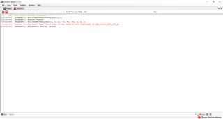

I am about to put the cascaded radar into operation and have strictly adhered to the instructions in the user guide. C: /ti/mmwave_studio_02_01_01_00/docs/mmwave_studio_cascade_user_guide.pdf However, I come to the point: -Perform the firmware download for all the slaves together. Perform RF Power Up for each one of the slave devices individually. Perform the basic configuration in Static configuration tab for all the slaves together. Also, the cascading mode for all slave devices should be selected as “Slave” during their basic configuration. not further. Which APi's do I still have to configure? If I want to run the "Frame Config" after the "Static Configuration" and set RadarDevice1 as "SoftwareTrigger" I get the following error message:
What am I doing wrong ?
Best regards
Paolo

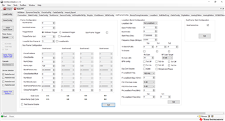

  • Hallo Ishita,
    i did the configuration as in the  mmWave_studio_user_guide.pdf and Cascade_Configuration_Basic.lua
    When i want to set the Frame Configuration for the first Device i get the following error:
  • Hello Paolo,
    After running the Cascade_Configuration_Basic.lua  script, did you press the "set" button for profile and chirp config before moving to the frame config?
    Referring to the error message you're getting, it states the Chirps used in the frame config are not configured and that points to the fact that you've not issued the chirp config API.
    I would suggest using Cascade_Configuration_TestSource.lua first which provides complete configuration.
    Ishita
