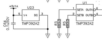

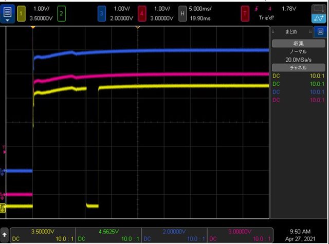

OUT A / B may go low only once after power-on reset. The actual temperature should not have tripped as it will soon become HI.
When the on-board power supply is disconnected from the TMP392 and an external DC power supply is plugged in, OUTA works fine, but OUTB sometimes outputs a Low pulse.
The circuit is below.
SETA / B = 680k
Blue : Power supply
Pink:  OutA
Yellow: OutB
I'm investigating this error, does TI have any insights?

    Does the customer only see this behavior when starting up with the DC Power supply, and never with the onboard power? Are these tests being performed at room temperature?
    Can you share a bit more of the schematic, specifically I would like to see what OUTA and OUTB are connected to, and what the pullup values are.
    Also, if possible, can they probe the SETB pin during one of these events?

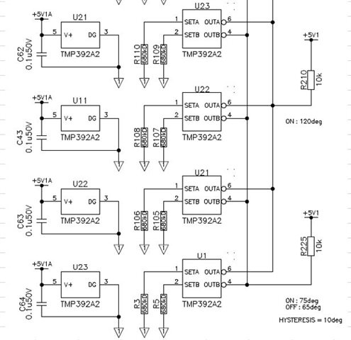

    As a result of removing "L1", "R40", and "C27" and using an external power supply to isolate the problem, only OUTB output a low pulse.
    ・ 8 x TMP392
    ・ 8 x OUT A / B is wired OR connection & 10k ohm Pull up
    Therefore, which TMP392 is outputting the pulse? It's difficult to judge.
    Also, since it is not possible to monitor 8 SET Bs at the same time, the customer has started to modify the circuit.

    Thank you for your patience. After checking with our team they agree the most likely cause here has to be the supply noise. In the presence of enough environmental noise you could see the TMP392 trip like this. This is because the TMP392 samples the resistors twice at startup, and pulls down as an indication of an issue when the resistor values it decodes do not match.
    The best option here would be additional supply filtering (as you've noted). If their power supply performs better under lighter load, or if they have other components generating significant noise, it may also be beneficial to stagger startup of the TMP392 and other components.
