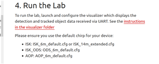

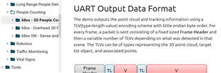

Have you had a chance to look at the User's guide in the Tirex lab/demo where the data format is listed.
The update rate is per frame and frame periodicity in the profile config sets this.
For Data format:
https://dev.ti.com/tirex/explore/node?node=AAMBDqRctFUaJ4xh6n3SbQ__VLyFKFf__LATEST (Or Navigate to Industrial Toolbox -> Labs -> People counting )
Config file: See of the files here:
For explanation of basic Chirp parameters
mmwave_sdk_user_guide.pdf ( or Get the latest from mmWave SDK page )
See section :

This CSV file only saves the pointcloud and tracker data from the UART stream for each frame. This is the only output for the default project binaries for the people counting. What exactly are you referring to by subframe data? What other data are you hoping to get?
Also, the frame rate is located in the frameCfg command in the cfg file, it is set to 120ms period by default.
