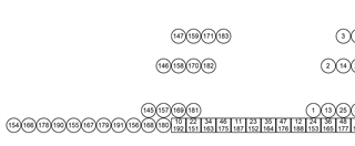

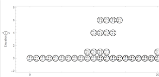

Taking the geometry of the Transmit antennas, we have the following layout:
Taking the geometry of the Receive antennas, we have the following layout:
Combining all possible Rx and Tx configurations we have a geometry as follows (where only the leftmost part is shown and the plot is upside down):
So therefore, the leftmost antenna phase center corresponds to Tx Device 4 channel1 together with Rx Device 4 channel 1.
2: QUESTION: Is this correct?
Repeating the same for all antennas but using the antenna index {1.....192} we obtain:
Now we note, that the squares show antennas positions that are redundant, e.g. 10 and 192.
This implies that e.g. (10): Tx-Chip 4 channel 1 Rx-Chip 1 channel 1 and (192): Tx-Chip 4 channel 3 Rx-Chip 4 channel 4 share the same phase center and should be related.
3: QUESTION: Is this correct? Are e.g. 10 and 192 duplicates? If not something would be wrong in the numbering scheme.
