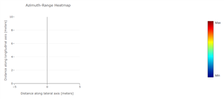

I am using IWR1642Boost and want to see the Azimuth-Range Heatmap data with the mmWave Demo Visualizer.
I first flash the OOB demo bin with SDK 3.5 to IWR1642BOOST, then connected it to the mmWave Demo Visualizer (Browser version) with uart cable (115200 for command, 921600 for data).
I was successfully plotting the detected points with the mmWave Demo Visualizer with the default settings of "Best Range Resolution"
Then, I choose to show "Range Azimuth Heat Map". However nothing was showed. I didn't reset the device before I send the new config to  IWR1642BOOST.
What is the possible reason?
Thank you very much!

  • Hi Vaibhav,
    Thanks for reply. Yes, I can see the detected pointcloud using the mmWave Demo Visualizer.
    However, when I chose the Azimuth heat map, nothing was shown.
    I have attached the cfg file. Thanks a lot.

  • Hello Hang,
    Thank you for providing these details. Heat map must be selected before sending the .cfg. If you are still unable to see it, ensure that the frame rate is low (less than 5 fps).
    Finally, be sure you are using chrome for better performance.
  • Hi Sabeeh,
    Thanks! My bad, I should set the frame rate manually (less than 5). It works!
    Hang

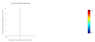

  • Hi Sabeeh,
    Actually, I have another quick question on the frame rate. I set the frame rate low than 5fps, then send the config to the IWR1642Boost and it worked.
    However, in the cfg file, I didn't see the frame rate parameter. How the cfg file worked to make the frame rate lower?
    Thanks a lot!
    Hang
  • The fps is changed in frameCfg.
    For more information on chirp parameters, please see Table 1 of the mmWave User's guide after installing the mmWave SDK: https://www.ti.com/tool/MMWAVE-SDK
