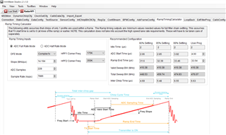

  • Hi Zigang,
    Thanks for that. I tried that before, but I do not get the same results. For example:
    profileCfg 0 77 8 7 28    0 0 20    1 256 12500 0 0 48 % from the *70m_MIMO_3D.cfg file
    profileCfg 0 77 2 4 33.91 0 0 14.19 1 228  7886 0 0 30 % from the sensing estimator tool
    frameCfg 0 2 40 0  50 1 0 % from the *70m_MIMO_3D.cfg file
    frameCfg 0 0 40 0 100 1 0 % from the sensing estimator tool
    The values I entered in the tool are in the image below. When I try to use these new values, the board freezes immediately after the sensorStart command. Help please.
    Carlos
  • HI,
    The golden reference to check the ramp time related parameter (idle time, ADC start time, ramp time) is to go through the "rampTimingCaculator" tab inside the radar studio.   I checked for you in your case, it looks fine to me, see the picture below.
    Can you keep the profile configuration, but keep the all other chirp configuration and frame configuration like below?
    chirpCfg 0 0 0 0 0 0 0 1
    chirpCfg 1 1 0 0 0 0 0 4
    chirpCfg 2 2 0 0 0 0 0 2
    Zigang
