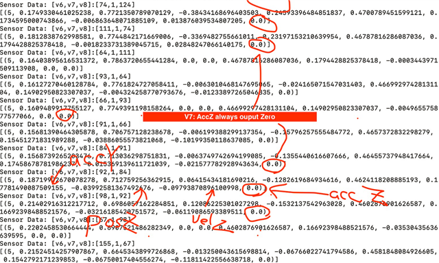

I found the accZ value always Zero in Target List Structure on People Counting Lab
Please double checking how to fix this issue
(1) Parsing Report as following,
     for example:
     Sensor Data: [v6, v7, v8]:[74, 1, 124]
           // V6 points number := 74 (at frame n)
           // V7 target list := 1
          // V8 target index := 124 (at frame n-1)
     Target List Struct:
    tid: Int        #Track ID
    posX: float     #Target position in X, m
    posY: float     #Target position in Y, m
    velX: float     #Target velocity in X, m/s
    velY: float     #Target velocity in Y, m/s
    accX: float     #Target velocity in X, m/s2
    accY: float     #Target velocity in Y, m/s2
    posZ: float     #Target position in Z, m
    velZ: float     #Target velocity in Z, m/s
    accZ: float     #Target velocity in Z, m/s2
